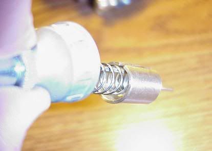

Dax does have a installation manual on his site...well I've got time here you go....from Dax
Remove the cap and all parts
Place needle into center of carb slide and then put flat washer with groove on top of needle making sure you have the groove lined up with the groove in the carb slide
Install cable to plastic grip, then thread this end through the carb cap and spring
Compress spring and load cable into the end of the slide.Put the entire lenght of the cable into the slide, then release the spring inside the carb slide and allowing the spring to push down the washer and holding the needle down
nice, thanks for all the help guys. i guess i'll go to the store and get a low profile spark plug to try. as far as the carb goes, i did see those pics on his webpage, i just didn't think about it i guess rotfl i'll give you an update later.
