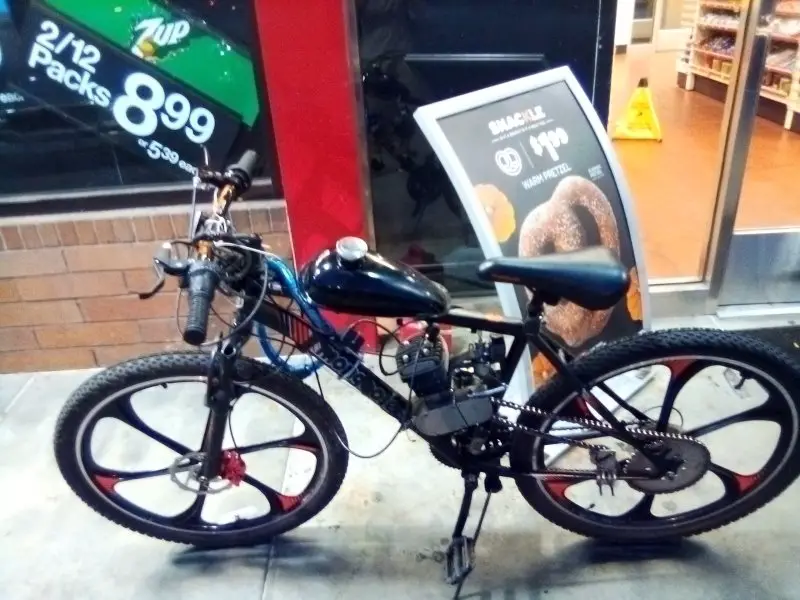

Ok, I know I'm going to get some **** for this but I ran straight oil now she won't start, it'll pop and fire every 3 rotations of the pedals. I took the head off, cleaned it out with gas and cleaned the carb. No plugged jet. I'm at a loss of what to try next, I've dumped the old gas and properly mixed some new gas. I changed the spark plug, the CDI and magneto, it's getting a spark, the air filter is fine. It acts like there is water in the gas. Please give me some feedback. Here's a picture of it. Haven't got around to cleaning it up but after I get it running I'll clean it up.
