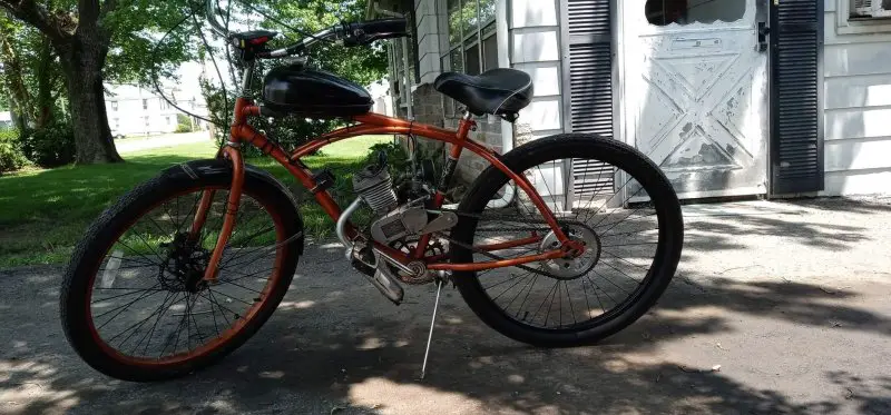

This is mine. I dont know much about it. I know i need a new chain for the motor, but no markings on the old chain. anyone know what size im looking for?

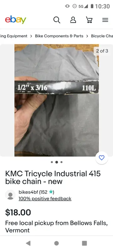

I've been recently buying chains and the 110link tricycle chain is the longest one available now... 112 or 114 have been out of stock everywhere... If you know how many links you need... Another option is to use 2 98 link chains put together and use 2 master links just cut both chains so you have the master links an equal distance apart and not just add a small piece to so when the engine is pulling one master link at a time and not 2 close together
