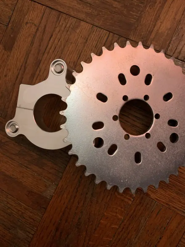

Hey guys, I bought a engine from amazon about a month ago and was struggling to find a bike that I could mount it on until today. I have also bought a sprocket adapter, I didn’t want my spokes to bend with the one that comes with the kit. The bike I’m attempting to mount the engine on is a regular fixie bike. I was wondering if anyone knew If it’s a bad idea to use the 16 tooth sprocket that comes with the bike.

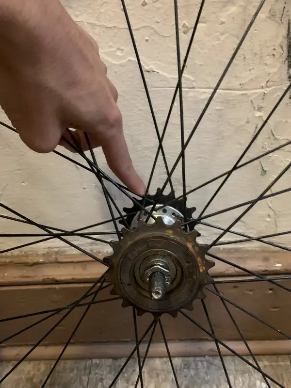

Hey there Greg, I really appreciate the reply! What I’m trying to do is get up the engine kit on a golden cycle fixie. I want to connect the engine right on the fixie gear since the rim has two little sprockets on it (one for fixie mode, another one so you can pedal backwards and not get smacked with the pedals)

Like both before me stated using that sprocket will not work, the smallest rear sprocket I’ve hear of someone using is a 28t. With a 28t plan on doing a lot of pedaling, here in Georgia the smallest I can run is a 38t because of hills.
I do have the sprocket adapter, but the hub of the wheel is way too small. There’s a bike shop around me that said they would be willing to attach it, not sure how but they said one other guy came in with the same issue. I really don’t want to use the one that comes with the packet because it’s on fixie rims and I’m sure those spokes won’t last.
Joshua actually buying the correct 26" cruiser bike, coaster brake, wheel with 12 gauge spokes 36 spokes and 1.5" diameter hub wheel fit your 1.5" adapter is probably the cheapest way ($75. or less) new or $10. for a good used one, to get this thing going and actually work correctly. Final drive sprocket with the kit engines, like Greg said, 38 tooth, for flatland use or 44 tooth for hilly....54 tooth for San Francisco!
