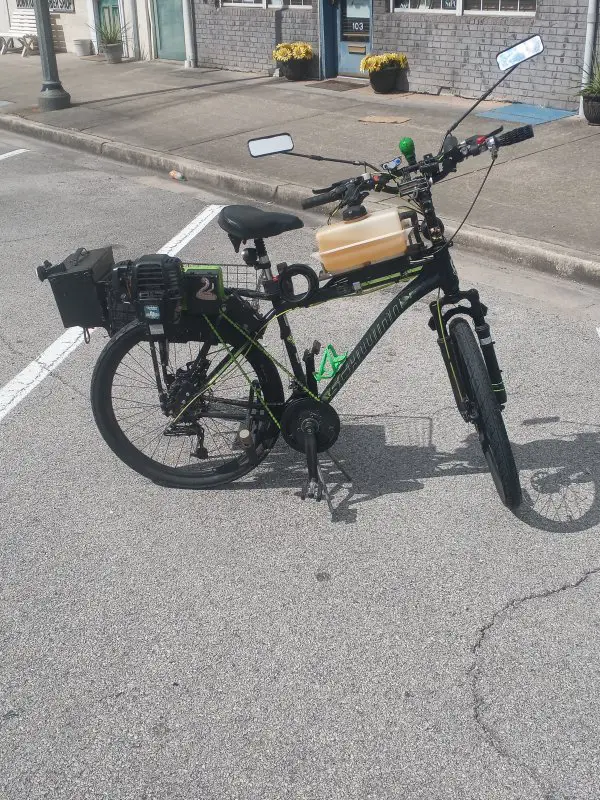

Here's my bike.Maybe what have you got in mind ?

Very cool how does she ride ?
Triple chainring shifter, 33cc, I live in the mountians and weigh 230 lbs. Set up is on it's second bike. Been riding for 12 years. Have conversations almost every place I stop.Very cool how does she ride ?

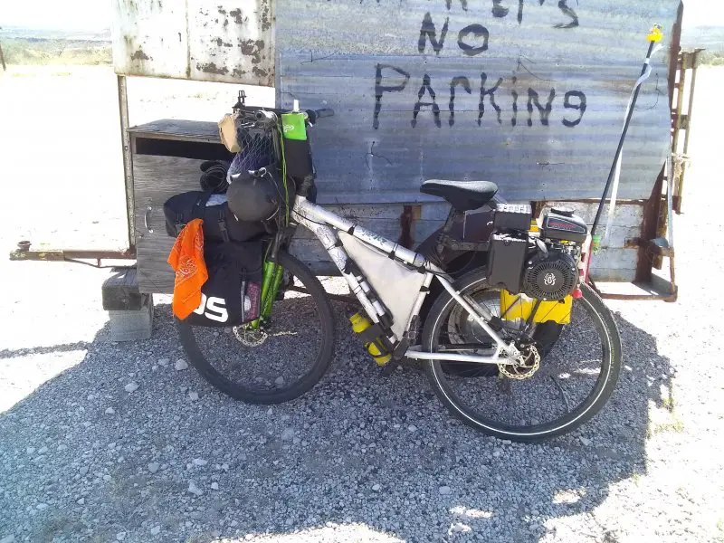

This is the bike i used to go across America.
