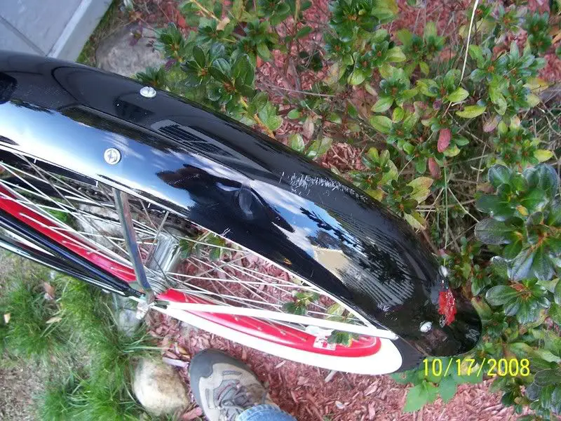

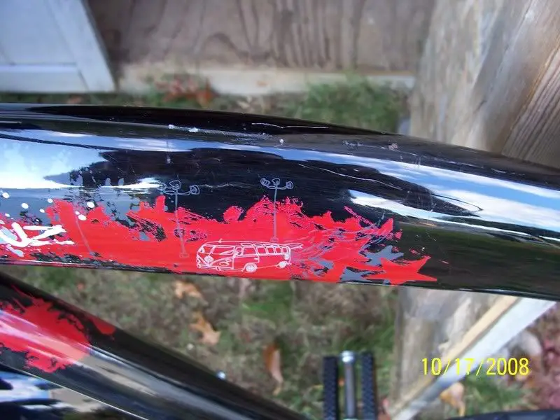

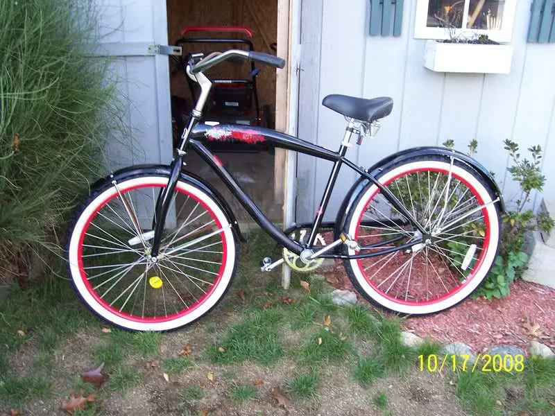

    I found this Diamondback Della Cruz at a garage sale yesterday and picked it up for $40. It still has all the nubs on the tires since it hasn't been ridden except for a couple times. The problem is they shoved it in the back of the garage and stacked stuff all over it. I took a couple pics of the dent in the rear fender and scratches in the paint. So do ya'll think I should tear it apart and repaint before adding the engine or just go ahead and put an engine on it?

    DARN!!...I wanted to be the ONLY one with that bike :(......rotfl
    I think if you want to paint the bike, that is a personal choice up to you. But now is the time to do it before you mount the motor.
    I paid $15.00 for mine brand new still in the box at a yard sale, I've been very happy with it. They run between $200-$300
    You will have to have a frame adapter for the front mount...I drilled mine but I would not recommend that to any one. And it's a tight fit with carb at the seat tube but.
    And the most important...if you plan to keep the fenders on you will need to modified the mount for them. The stock one will break in the first few rides and could be a big danger!

    SCORE on the diamond back! good deal there. Gonna be a sweet MB.

    OH, and big time what Mr Fair said. Fenders need attention!

    Fairracing 31, thanks for the link. I can't see in the pics what you did to strengthen the fenders. Did you just use different bolts and washers and things to strengthen the attaching points so nothing could get loose? I'll scour the board and see what else I can find on your build.

    I'm not really liking all the decals and stuff on the bike the more I look at it. I'l probably take everything apart, sand it and repaint it solid black. It's got to be easier to paint this than the Jeeps that I've painted in the past.

    Paint stripper might be useful. Those decals can be tenacious!

    would a blow dryer work on decals? Works wonders on truck lettering, but they are much thicker.

    (jaw goes slack) Now why didn't I think of that when I was doing that job! I even own a heat gun already!!!! :oops: :rolleyes:

    I replaced it with some very hefty "L" brackets...and tacked and riveted them to the fender.
    I will try to get some pics up later today
    Here is a link......http://motorbicycling.com/f30/motorized-bicycle-front-fender-dangers-315.html

    Are those front forks turned around backward?

    Fairracing31 thanks for the link. I think I know what I'm going to do about the fenders.
    I just went back and looked at Fairracing31's pics and I think my bike was put together wrong from the getgo. My forks are backwards compared to his. I thought it looked a little funny, but now I know it's not right. I'll take care of that when I start disassembly this weekend. Thanks for the headsup. That could explain why the front fender hit my toes when turning when I took it around the block for a spin the other night.

    Maybe thats why you got such a good price for it. Welcome to the fun.

    Yes, your forks are backwards.
