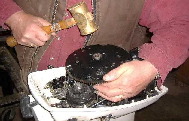

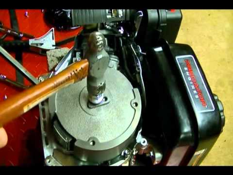

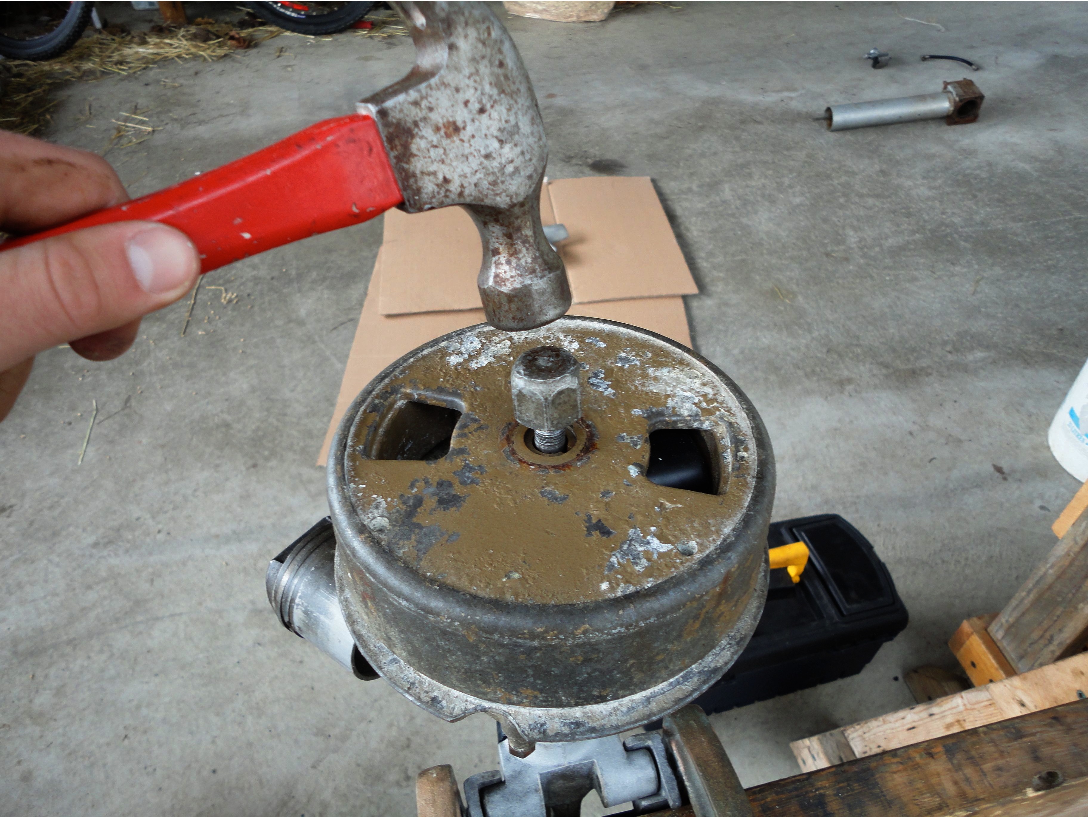

    Remove the bolt and washer retaining the helical gear.
    Set a much longer bolt to the depth of the threads.
    Heat the helical gear with a propane torch, but not the crankshaft.
    With 2 flat screwdrivers putt a little load on the helical gear.
    Give the long bolt a sharp snap with a steel hammer.
    Helical gear should come loose.
    Do NOT beat on the end of the crankshaft or beat the bolt unmercifully.
    Examples from webland:
    [​IMG]
    [​IMG]
    [​IMG]
