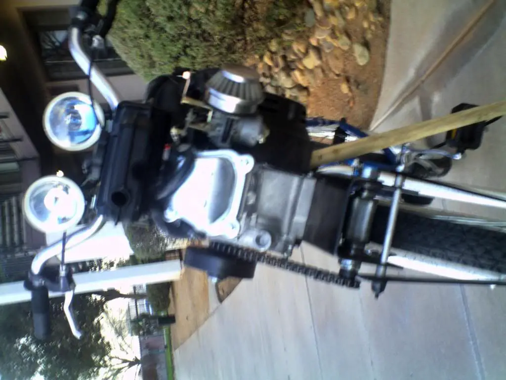

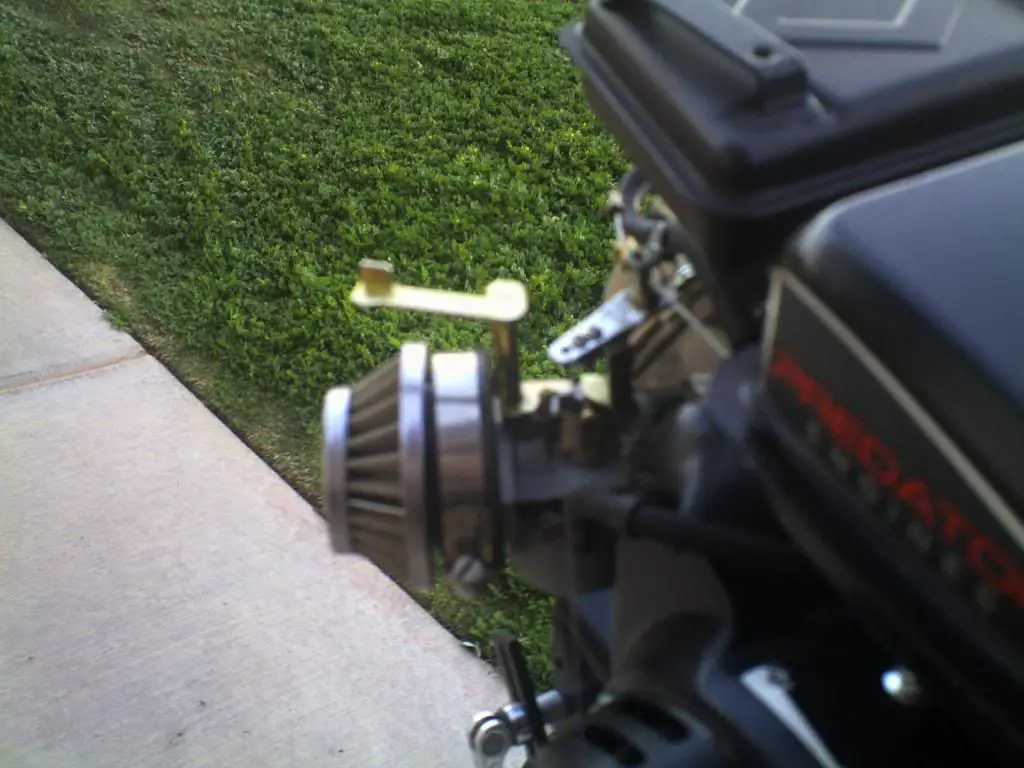

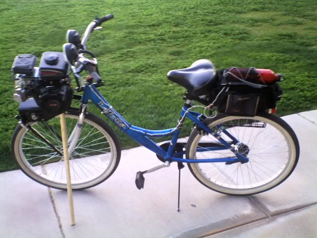

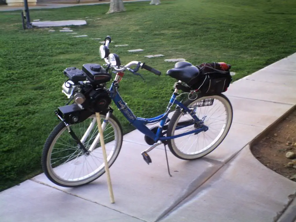

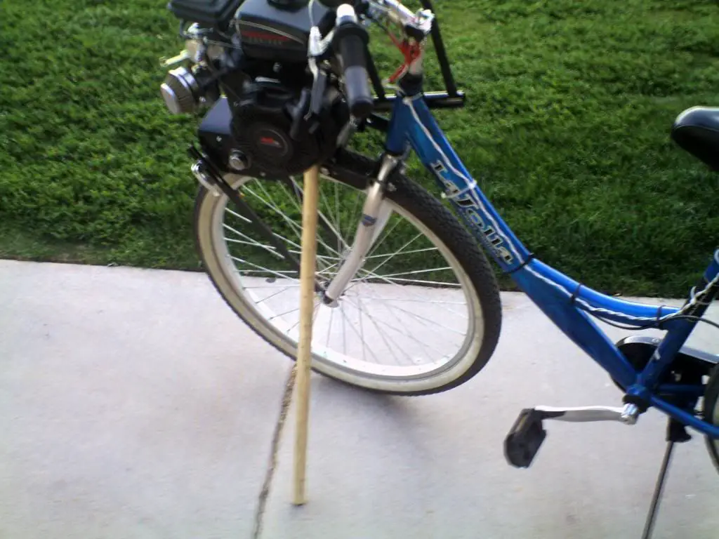

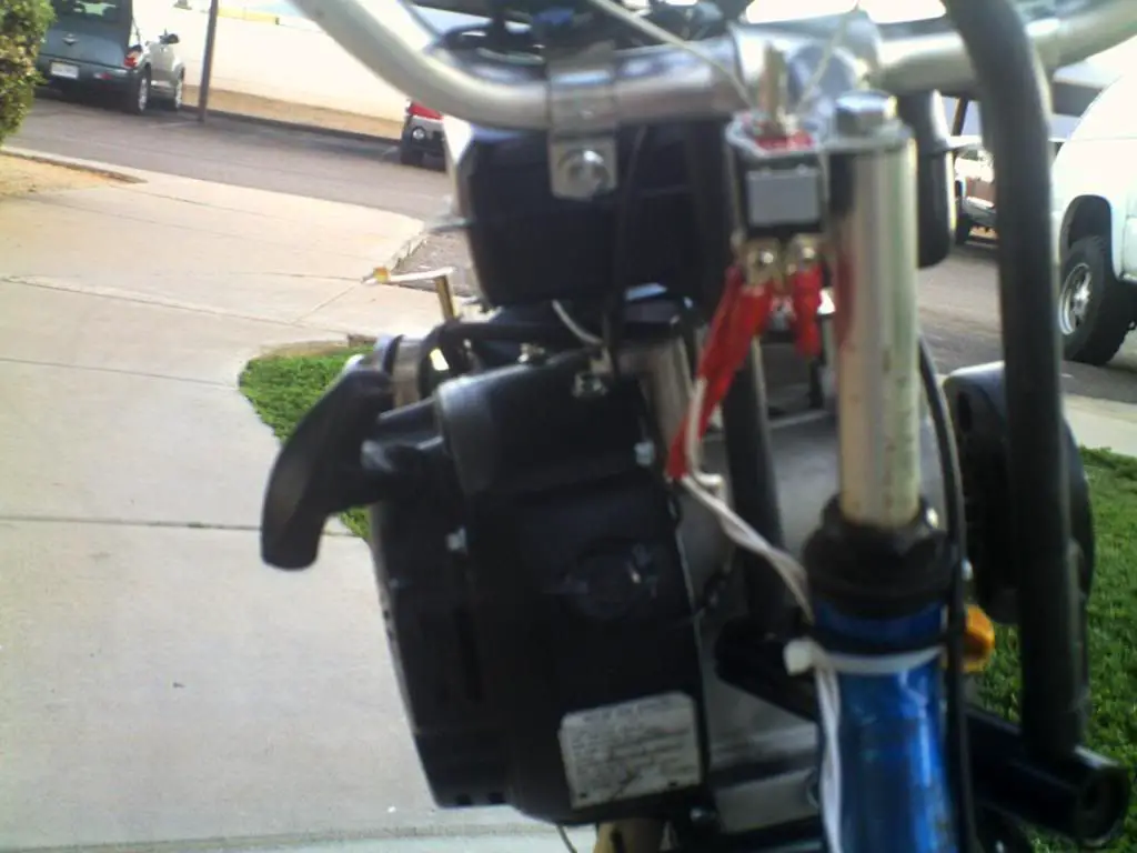

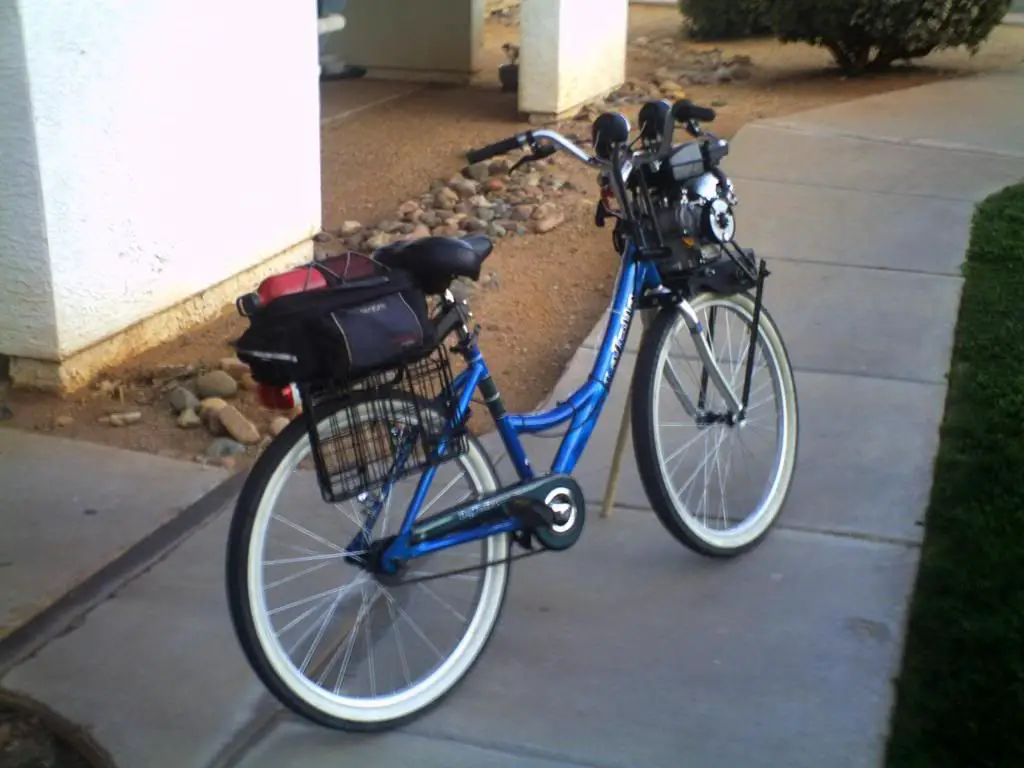

I finished the bike but of course there are problems.
I did not ream the sprocket out square and there is a lot of run out. It's not so much that it doesn't work but it's too much for my liking. I'm going to have to do it again.
I revved the engine on accident and the roller cut a huge gash in my tire. This motor has a crazy amount of torque. I'm going to have to get a new tire.
The muffler is very loud being up in front of the rider. It's very annoying

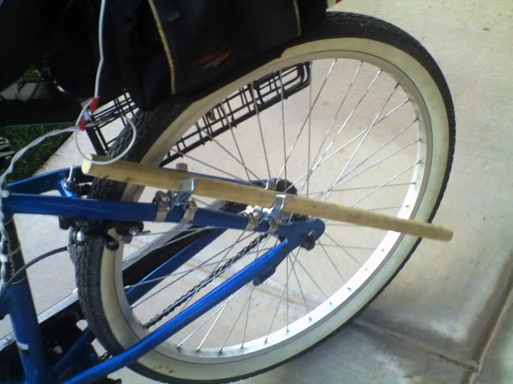

The bike will not say up on the center stand on it's own and i have to either lean it against something or carry a stick around the prop up the engine. I can't think of a way to overcome this and I may have to put the engine in the rear.
On the good side the bike is pretty quick and doesn't have too much vibration. Lots of torque to take me from a stop.

Looks great MP! If you like the way the bike works/rides just tweek it. I had to build a stand for mine(check the link earlier in this thread), it wasnt difficult and it worked great. The muffler can be tamed with probably a simple turn down pipe. It will require a good deal of down load on the tire to make the smaller roller grip. I find the best grip around 30psi. You have a ton of power to pull lower pressures unlike a smaller engine. Ride it some, if you like it, refine it until its where you want it. Most of my bikes are in a constant state of refinement, and eventually wind up to be very nice rides.

I used a axle mounted kickstand on my Hongdu fronr mount. It works great along with the regular frame mount kickstand. Might work with a centerstand too.

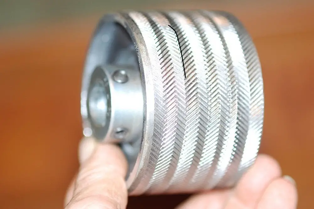

If you would change to a much larger roller, you will be very suprised how much better the traction is, and how much less the rolling resistance is.
The only reason most FD rollers are small is because they normaly have to run at crankshaft speed and they need small dia. to get the ratio right.
With the jackshaft, you can run a large roller and change sprocket to get good ratio.
I used a 3.5" roller on my in-frame preddy FD, and it WAY out performs the smallish rollers that all other FD's I'm famillar with.

That's awesome. where did you get that roller. I'm currrently using a 1.5" roller and the ratio could be a little higher
Hey Max, I fabbed this roller myself from a steel pully and a short piece of 3 1/2" pipe. I am lucky enough to have a small machine shop in my basement.

I use an axle mounted kickstand on the
front wheel on my solex clone bike. It, along with the regular sidestand, it is very stable when parked.

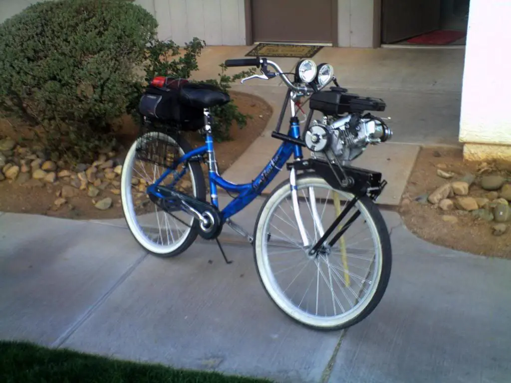

Way Cool! How does it ride? And only 49cc too(hehe).

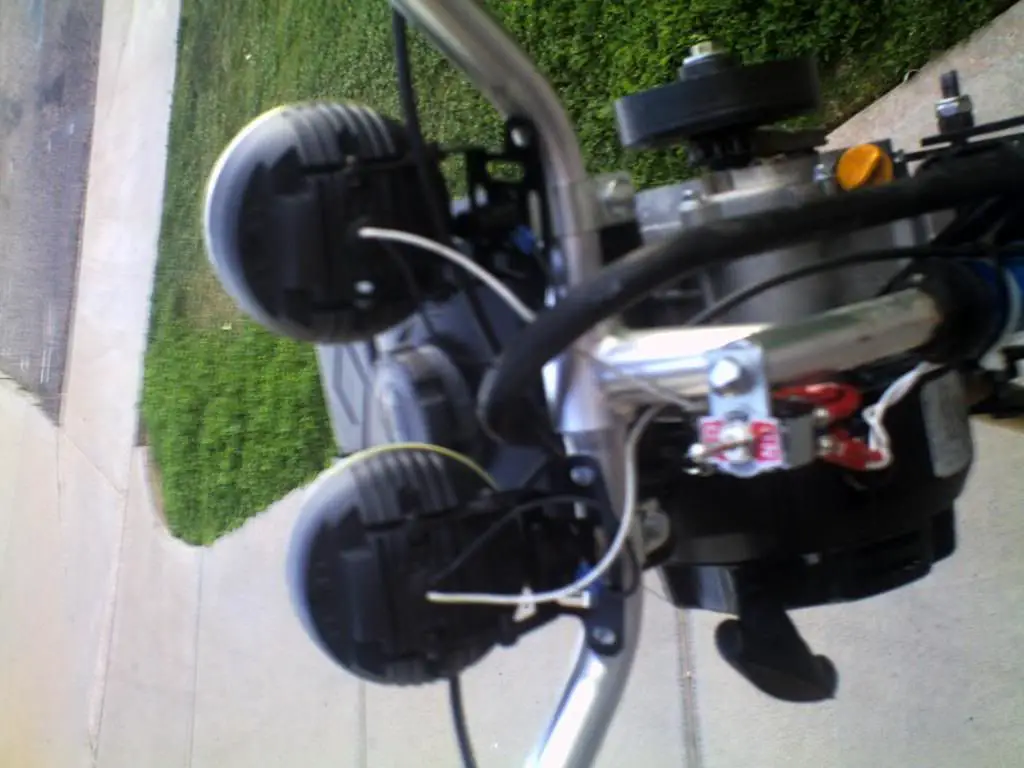

It rides very well. I thought there was going to be much more vibration than there is. I think I'm going to make a custom exhaust for it to quite it down a little. I kind of wish it was geared a little higher but this ratio will pull me from a stop. I really like wayne z's vari speed tranny and considering retrofitting mine. Night riding is great with the two 55 watt headlights I'm using. Braking power could be better. I wanted to put the caliper brake on the front but it would not fit with the kit. I know it's just a matter to time until the walmart bike blows up.
Do like Wayne suggested with a bigger roller. I dont know how much clearance you have in the channel but if you can squeeze a 2" in the top speed will be around 30mph and it will pull from a stop. Will be queiter too. My Schwinn bobber with the Preadator runs a 2.6" roller via a belt at a 1:1 ratio, has a top speed around 40 and pulls easily from a stop. If you can use a 5/8 shaft with what you have now, making the roller would be no problem.
