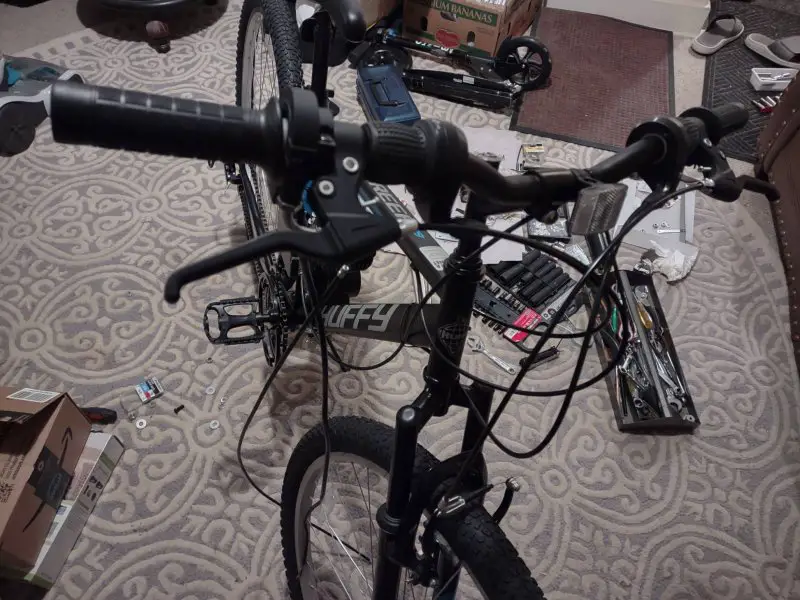

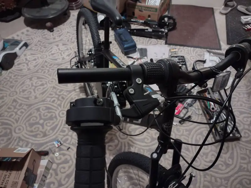

Hello! Sorry if this has been asked before, but I'm brand new.
I'm building a 2 stroke engine kit on a Huffy 18 speed mountain bike. I had limited funds and picked the best bike I could find that would fit the engine.
But the current problem I'm having is the handlebars :/ They are a bit short with all of the hardware and controls, as I opted to leave the 18 speed shifters on (in case I needed to ride the bike manually).
So the grips extend about 1 1/4" past the metal handlebars with everything on. I don't like this really from a safety standpoint.
What's more the throttle that came with the kit, slides on and although it screws on where the kill switch is, it just feels loose and twisty, as it came in two parts, with the handle having a plastic disc on the end that fits inside the kill switch mount. Is it supposed to be like this?
It just feels weird riding a motorbike holding on with the handlebar loose like that.
Anybody have any thoughts?

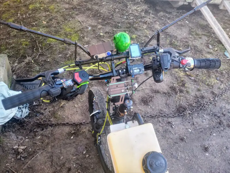

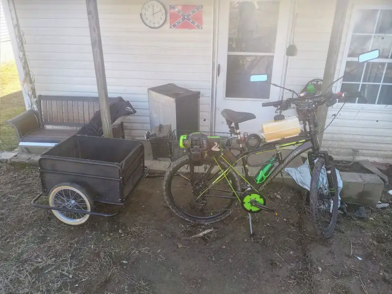

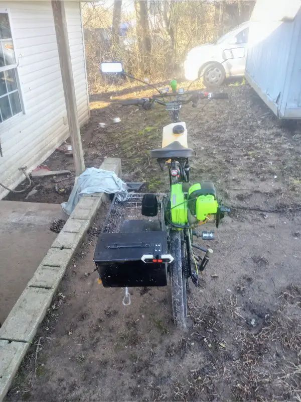

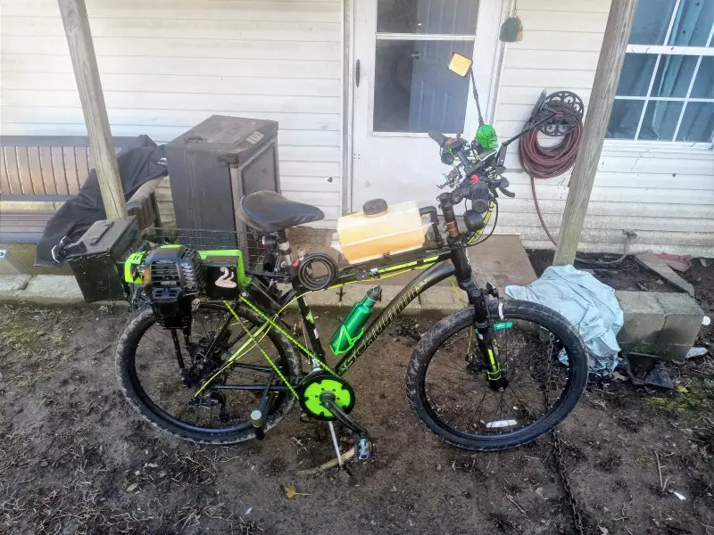

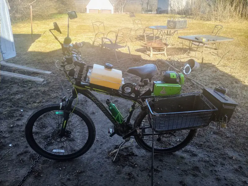

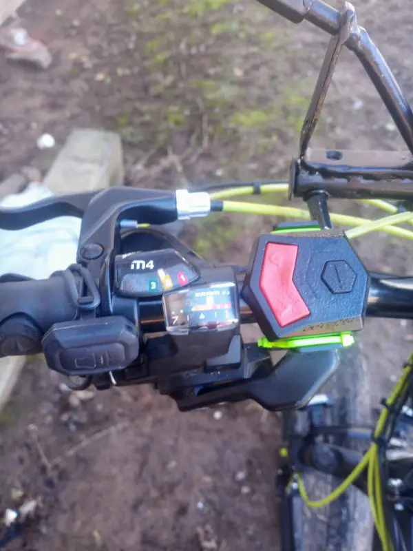

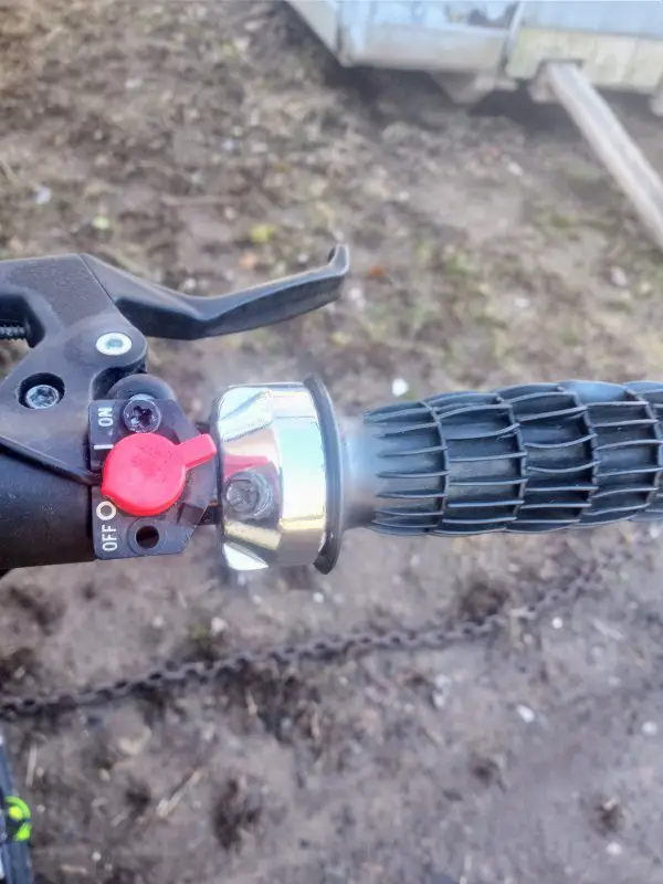

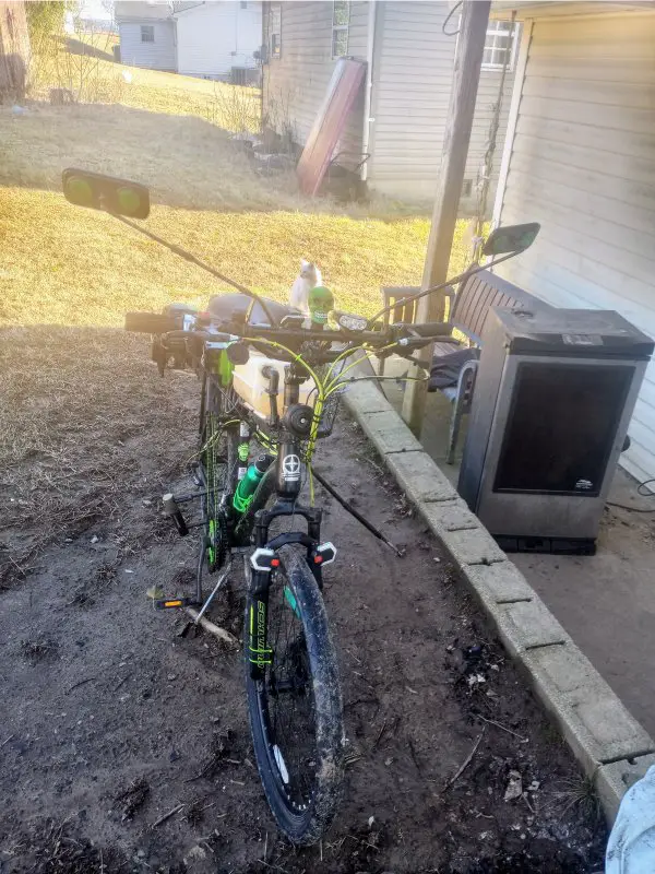

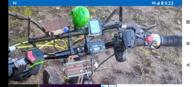

Do I have have some pictures for you. Here's what's possible with our bikes.
My system allows all shifting to be done with the left hand. The front shifter is a shifter/brake combo.
The way I'm able to put so much onto my handlebars is by using an extender bar.
My throttle used to move also. So I used a self-tapping screw to stop it from moving.
The really good thing is our bikes can be used for more than just riding pleasure.
I would keep it simple... It's a bicycle anyway ;)

My mirrors don't vibrate. However one could use helmet mirrors. You can see a lot more behind you with mirrors than you can by twisting your body.
Signal/brake lights are a big help when riding in traffic since many don't know what hand signals mean. Loud horns help alert others to your presence. The key to safe riding is:

Did u drill a hole in the handlebars for the little pin inside the kill switch housing? That’s what’s supposed to keep the whole assembly from rotating when u turn the throttle.
Get a CNC throttle for 7/8 and kill switch to match those plastic throttles aren't worth the time to drill a hole
Wish I knew that when I built my bike lol. But I wound up buying a silver cnc throttle assembly and I love it. Never had a problem since I got my cnc one. Get one it’s worth every penny.

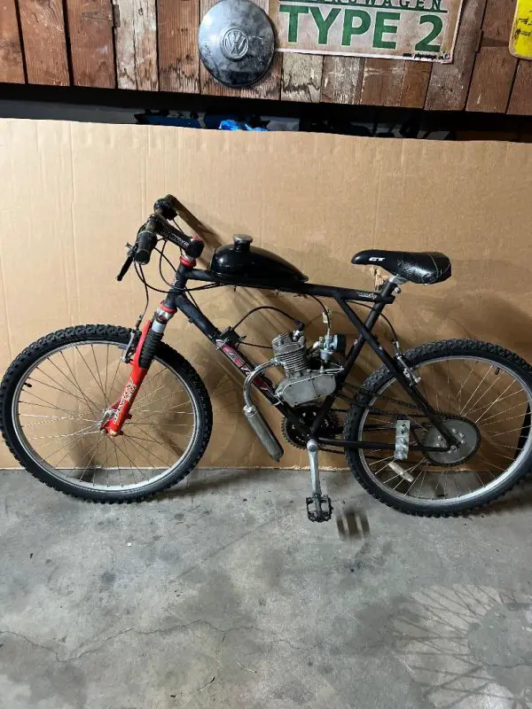

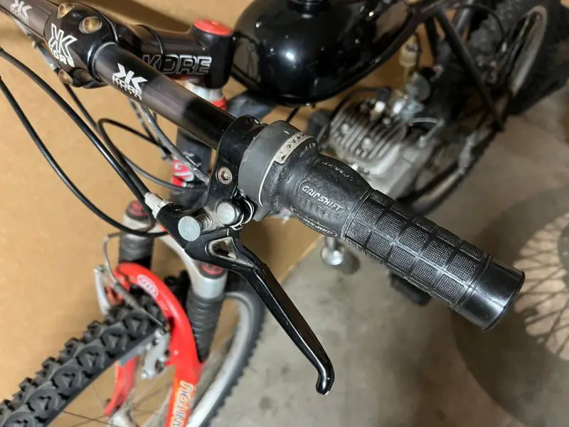

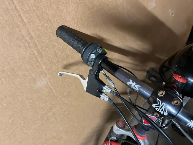

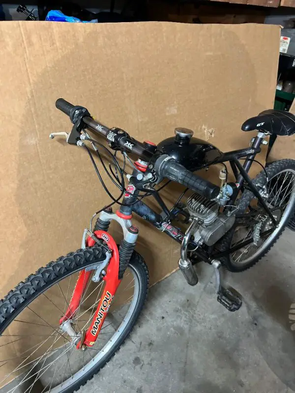

Here's a customer's bike that I've been working on & I thought I'd post some pics of how I do the bars on mountain bikes...
I usually delete the derailleur for the pedal sprockets because it's always in the way of the engine, & only have shifting for the rear wheel.
This bike was old & already built; I'm just re-working it... (I didn't put the screw in the throttle housing)
I installed a dual pull brake lever & relocated the shifter to the left side, & shortened all the cables to make it look cleaner.
This is just to show how I like doing it. (^)
View attachment 112055View attachment 112059View attachment 112060View attachment 112054
Jerry you have always been a voice of reason and a great inspiration to me and the rest of the community... but you need to slow down on the caffine bro, the amount of stuff you have on your bike exceeds the weight of the motor and the bicycle and it looks like you have a good coffee tweak going on.
I have to say that if you were in my town you would probably be pulled over just by the look of your bike because they would think that you're a meth head.... though I'm sure we could probably find our speed direction and destination of anywhere on the planet we were going with that bike.
( said with all the love and respect in the world) Batman would be jealous.
Batman would be show up looking for the latest disaster
