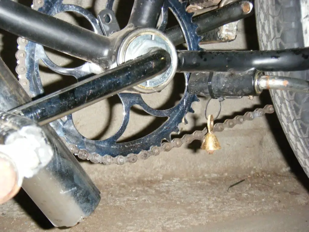

There is a old biker superstition, that you should hang a tiny brass bell on your bike as low to the ground as possible to keep the gremlins off of your bike!
If you look around at a lot of old Harley Davidsons, you'll notice bells hanging from them. (that's what they're for!)
If you look close at the pics of my "Bomber Bike" & my 1959 Schwinn "Rat Rod", they both have brass bells hanging from the kickstand mounts!
Thats that "old skool biker s*** baby!
Here's a pic of the Rat Rod bell...
