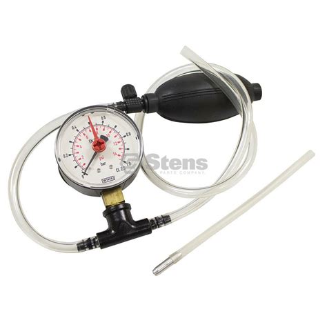

Are you getting spark do you have gas filter or is it clogged. Sounds like carb leak (see photo) or ground is shorted. how old is motor ?
tester.jpg Go to Dave's small engine repair @ U-Tube on how to test for carb leaks

View attachment 109916 Go to Dave's small engine repair @ U-Tube on how to test for carb leaks
