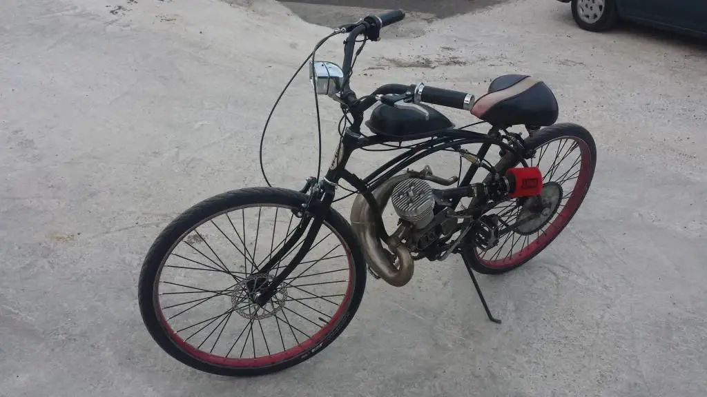

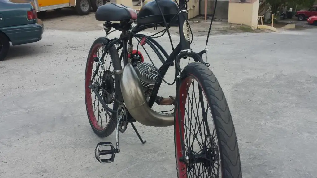

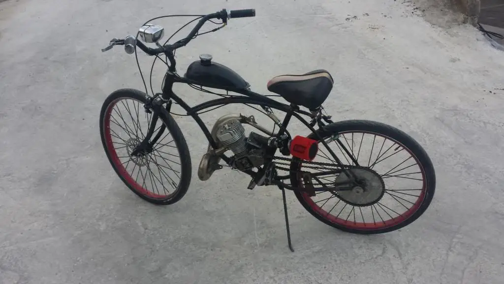

going case inducted!!!
it looks nice. if u shoot me dimensions of reed blocks i can tell u exactly. i believe the banshee reed to be no better than the worst reed block available but will support a 32mm carb.
I'm not sure how reeds can be better than another, it's all about what you're aiming for in the engine that determines the angle, material and style that you get. Of course, quality is a concern but I'd imagine any REAL scooter reed will be far better performing and near the same quality as either set of reeds designed for our engines.

It's not the first case reed on the HT (arrow had them on their 11hp race bikes for some time now), but very well documented, and definitely cool to find it can be done at home. Just gotta get yourself a real pipe now, boost that primary compression, and you'll be racing with the big guns. To my knowledge, arrow has been dominating the competition at the races.
His video states 1st case inducted in Puerto Rico.
Good job! I've been following your post since the beginning and was hoping that you'd finish - not like myself who has a tendency not to finish a project. LOL
Look forward to seeing more posts on your project.
Chris
AKA: BigBlue
Yes well done,
I was hoping to see that rear tire light up!
I'm not far behind.
What size rear sprocket you got there?
Looks like she'll be pulling wheel stands.
