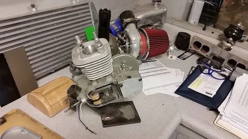

If you have a workbench or room for it in your shop, you could make a simple engine stand so you can start it before it goes in the bike... makes troubleshooting and basic tning real easy... Here's one I made up that holds the engine just fine for leaving on my countertop at the shop office, but when i need it for working or test running an engine, it just C clamps to a table corner or can be placed in a vise, then I just install a pull starter or a wider nut on the mag side and drill start it. For a fuel supply I got an old iv stand and just hang an old pocketbike tank with enough fuel for a short run, connect an exhaust to it, and it can be started and ran out of the bike, There are also some already made like the frame adapter for a china doll into a stingray frame that'll work the same way, I just had the metal and welded up this... It holds just fine for idle runs or even a few revs once clampped to a table.
