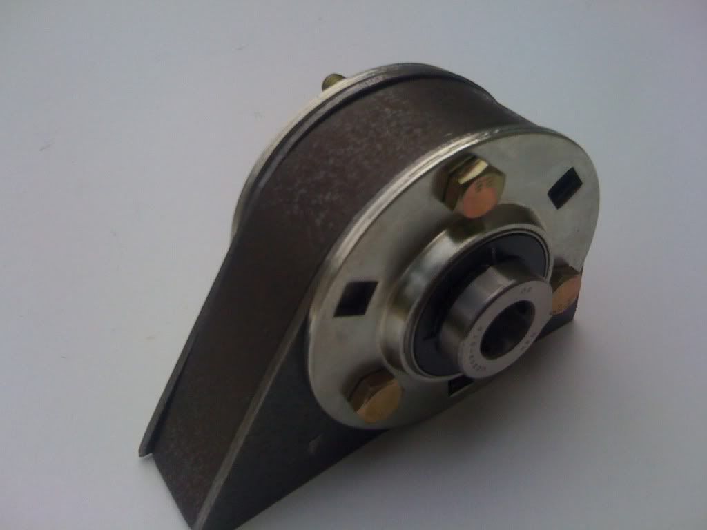

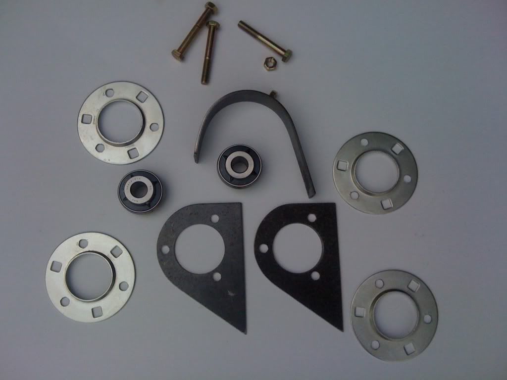

Should you decide to make a jackshaft theres many ways you can do it, depending on the pillow bearings you get. But heres how i made mine
You would have your pulleys/sprockets in a different arrangement but you get the idea
Harry , I really admire that j-shaft design you have there simple an straight forward .I think I will build one like it on my next build .
Gary
Thanks Gary, i plan on the same for future builds also.
