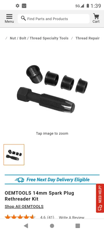

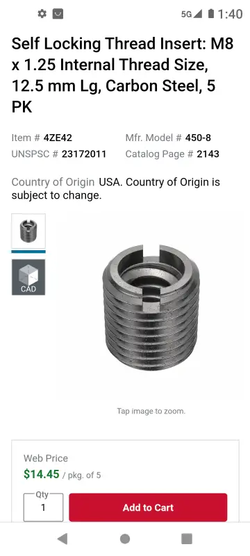

Something to have on hand or use as a preventative measure
