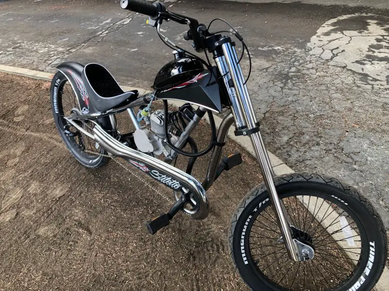

Front disc brake wheel for a Stiletto? I searched a long time for one with the heavier axle set up. Never did find. I got a sealed bearing quick release wheel that I machined new aluminium spacers that threaded onto my 7/16" fine thread axle. Had to cut and weld two hardened bolts together for that. In the end it works excelent and even has chrome acorn lug nuts. Cheaper and easier is a wheel set up for a freewheel and use a disc brake adaptor. You would have to make a short sleeve to make the smaller axle fit the forks properly though. And yes, my seat is getting wore out so I can finally put some more padding on it when I recover it. As far as freewheels holding up I have cratered only two. One was the cheap standard one from SBP. If getting a shift kit from them get the heavy duty. White industries makes a good freewheel. The other freewheel I cratered was the 7 speed mega-range. That was due to abuse. As far as shifting problems, none after the chain guide I built that feeds the rear derailer chain right onto the sprocket.
Masterm222, Thanks for the tips an info. I am going to look at some of the motorcycle shops, some of the smaller motorcycles use a 14mm axel. Maybe I can find a hub or even a wheel that will fit the front fork on the stiletto. Let ya know if I have any luck.

I finally got my front wheel back with a disc brake hub. I took it into a motorcycle parts shop they only sell parts no motorcycles same place I bought my bobber seat and hardware. They were more than glad to take care of it. They said it was the same type of wheel that comes off of a mini chopper, 14mm axel seal bearing 48 spokes. They had to send it out to have the hub and wheel laced. I think I'm through going to the bicycle shops, they have no interest in MBs. This shop has some really neat old board track racers in their front windows. Looks like old antique Harleys. Also bought a small peanut tank 2 gallon. It has 2 fuel outlets. I'm going to try to plumb it up to the RS motor and see if the return line from the carb will push it back up to the tank. If so I can use a tank on the engine as a reserve. I'll just have to seal the cap so it will seal the a vacuum. With the brakes installed took it out for a test drive. Flat straight asphalt went up through the gears, this thing will run. My cats eye speedometer said 46 mph and I didn't even have it on 3/4 throttle. This is a new enginge and I didn't want to push it any harder, and its way too fast for this old man. Did have some chain slap when I shift gears. But I can take care of that, I'll have to install an idler wheel before the derailer to keep the chain lined up.
Bought all I got left now is to paint and install the tank. do some pinstriping, I know this does not hae the cool look and you almost sit on top of the engine but Staton makes a damn good kit. I'll try to get somebody do some pics when its finished.

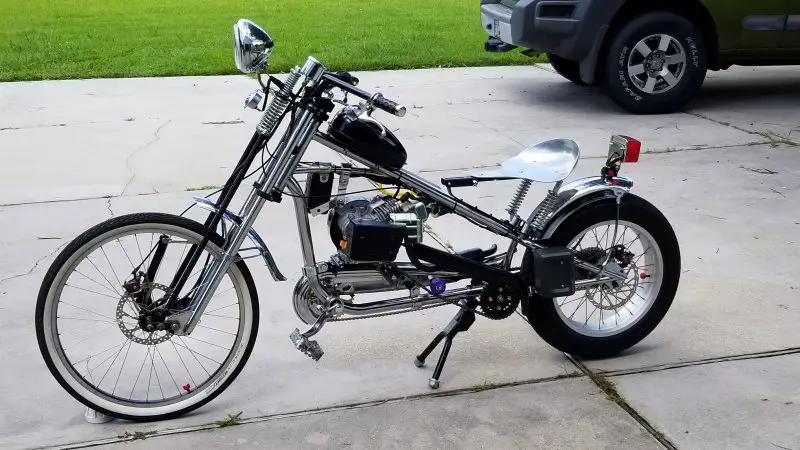

As far as shifting goes, I fixed the "Chain Jump" it liked to do at high speeds.
Attached a Shimano Internal 7 speed.
The original shifter is there as an idler, the chain was about 3/4ths of a link from being just right, and I did not want the chain to been as tight as it would have been.
I can say I'm finally 100% happy with this project.

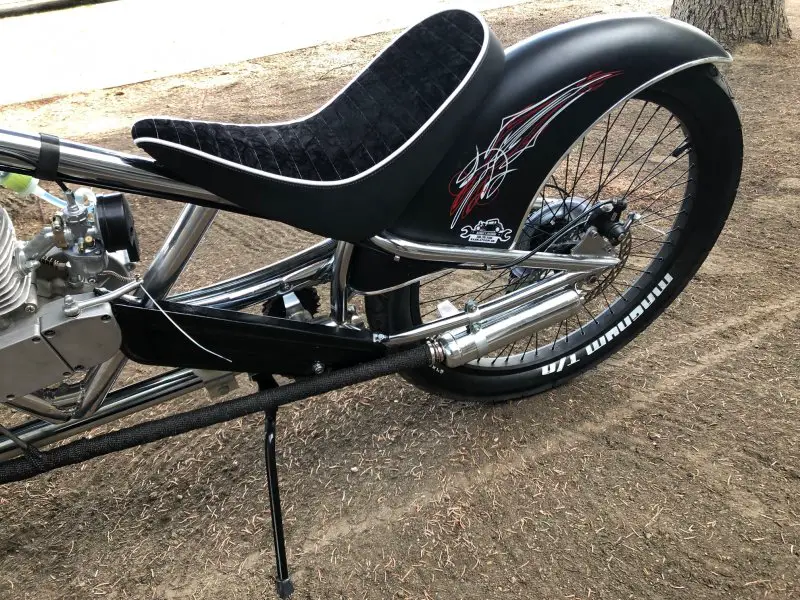

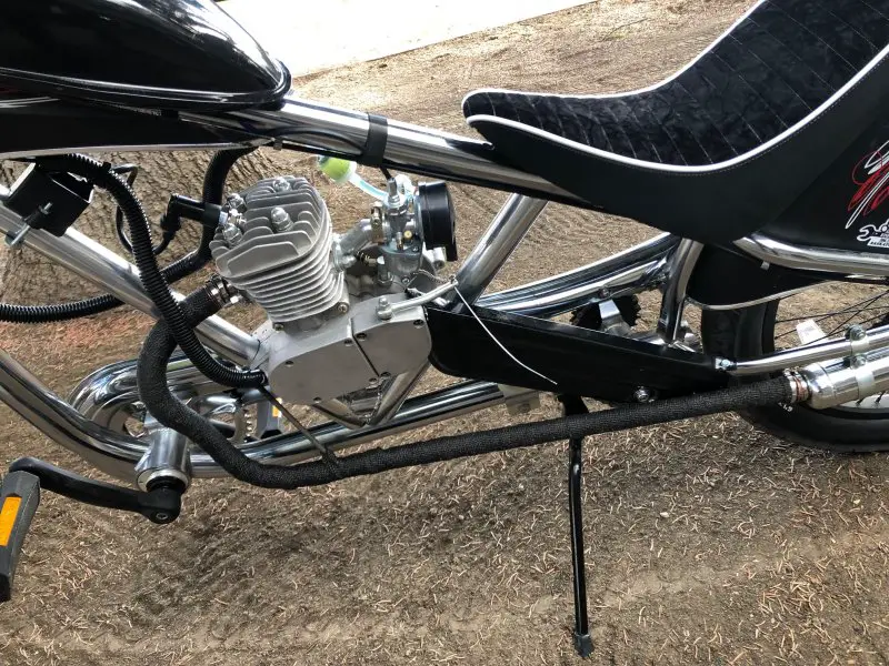

I bought exact same bike I bought a 20 tooth free wheel sprocket from bike shop remover original jack shaft then took outer most gear on right side had the same threads machined on to aluminum hum and put back on bike the left side I bought a 2 tooth hum and weld on hub welded together slipped on shaft and tightened set screw mounted motor and run chain to the left side sprocket the right side runs bike the same gears and brakes work the only difference is not pedals can free wheel while engine runs bike!!
