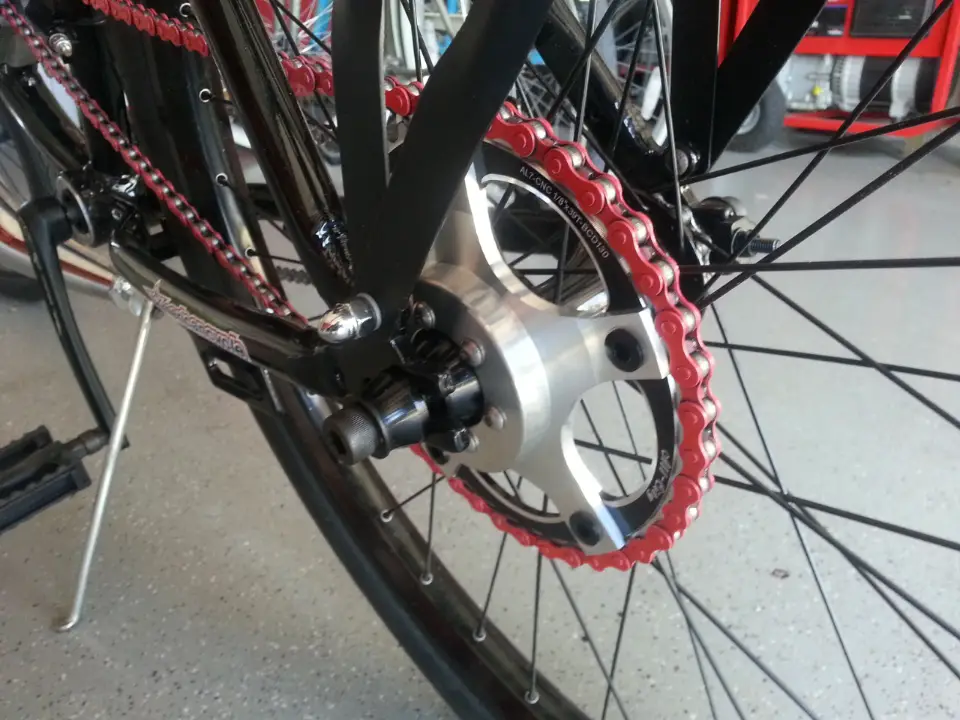

Looks great mike, dig the color scheme. I was going to be ordering a KMC chain as well, but it looks as though it won't work with the manic mechanic hub adapter setup I'm looking at getting. Speaking of, what sort of setup are you running for your back sprocket?
