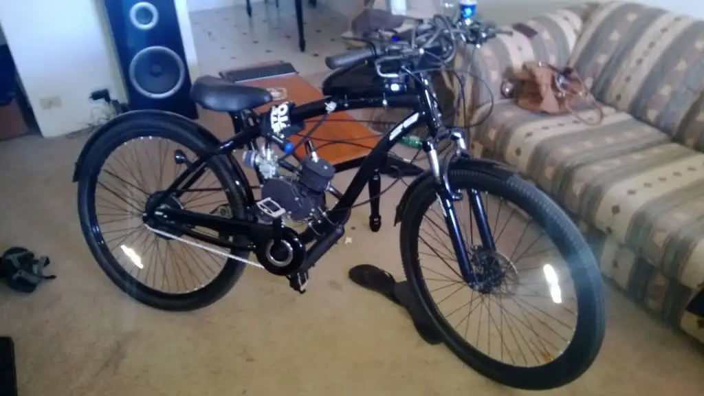

as was said earlier, buying the 29 inch mtn bike from walmart can add a lot of usable parts like the front end and levers/ cables /handlebars, but it's not without it's complications.
Here's mine with the mountain bike front end and levers.

Ok, the engine arrived yesterday.
I already installed the rear sprocket.
On the Onyx 29" with 48 spokes, the rear sprocket fits like a glove. The rubber dampers though, make it harder for the sprocket to fit, but in the end it does fit.
There's a small metal piece between the brake lever holder, and the wheel, that prevents dust to enter the hub. When you install the sprocket, you'll have to gently hammer this a bit flatter, or the space that the sprocket fills up, will cause friction, and coasting will not happen very well.
The 9 bolts DID fit, however a lot of prying is necessary.
By default 4 bolts fit perfect, and 3 fit kind of ok.
The last 2 fit under an angle.
So when inserting the bolts in the sprocket, the back rubber cushion and metal back plates (with 3 holes in), need to be carefully slided over the bolts, and some bolts need to be slightly forced straight to fit..
The kit came with plastic sealing bolts, so no double bolting is necessary.
I needed to take the back wheel off, and demount 3 times, because I forgot to insert the rubber piece (and didn't want to cut it), and later I forgot to install the chain before installing the wheel.
So 3 hours?
Forget that!
The rear sprocket took almost 1 hour to install.
Then the following problems occured:
1- the bolts for the cup/waterbottle holder where loose in there. Sucks because I had to damage the paint to get them out.
2- The cup holder does not fit by default with the engine. The exhaust is in the way.
3- The engine needs the universal mount bracket, because the front bar is too wide.
4- The gas tank provided did not fit the wide frame bar. I'm thinking of using zip ties, in the beginning, but later on buy a longer bracket that will fit the bike.
5- The kit came originally with 1/2 gal tank, and I bought a 1gal tank after that. You can not mount both tanks on the top bar, as there's not enough space.
6- Currently I installed the 32T sprocket, which I now regret; because the engine is comparable to a 33cc 2 stroke engine, not a true 66cc engine, meaning that at best it's performance will be equal to a 49cc 4 stroke engine.
I will see how it performs, and if it turns out that the engine can not keep up, I'll change to 36T
7- I'll be passing by my bicycle store,to buy a comfy saddle, and perhaps see if he's able to install a suspension fork, with disc brake.
So for now, I'm waiting for the zip ties and motor mounts to arrive, before I can say any more.
