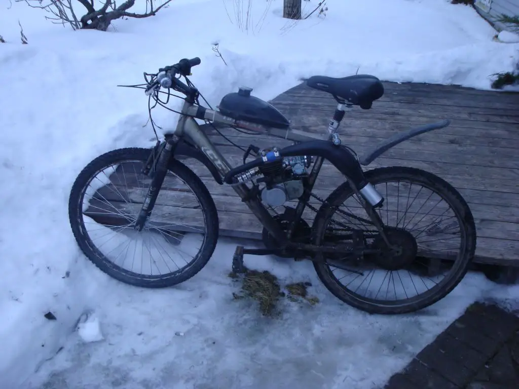

I don't know how handy you are as far as being able to adapt one to fit your bike, but Pocketbikes.com has expansion chambers on sale right now for $21.95.
They are like the one on the bike below. You would need to cut the two ends off, and weld on the ends from your kit exhaust. They work great and are really quiet.
John

Do you have a link to that site? I am getting the net runaround! Did find a cheap used one on ebay though.
Just Google pocketbikeparts.com Then scroll down the left side till you get to stock exhaust. Click on that and you will see several pipes. The one I use is the one that is on sale right now for $21.95. You can't beat it for the price. You can either use the muffler that comes on it, or cut it off and use the kit muffler if you want it to be nice and quiet!

RATTY ? look at retmachinists pick , that doesn,t look ratty to me
i never said it did. his looks very good, flows with the bike and compliments the over all look of the bike. but a big honking pipe just put on for the best performance offten looks like an after thought and dosen't add to the over all look.
to me a MB needs to be practical, and look good doing it. it dosen't matter how fast it is if it's ugly, if it's so out of proportion that it can't even be pedalled and has to rely soley on the motor for motive power or is uncomfortable to ride it will soon be setting in the corner with cob webs on it.
