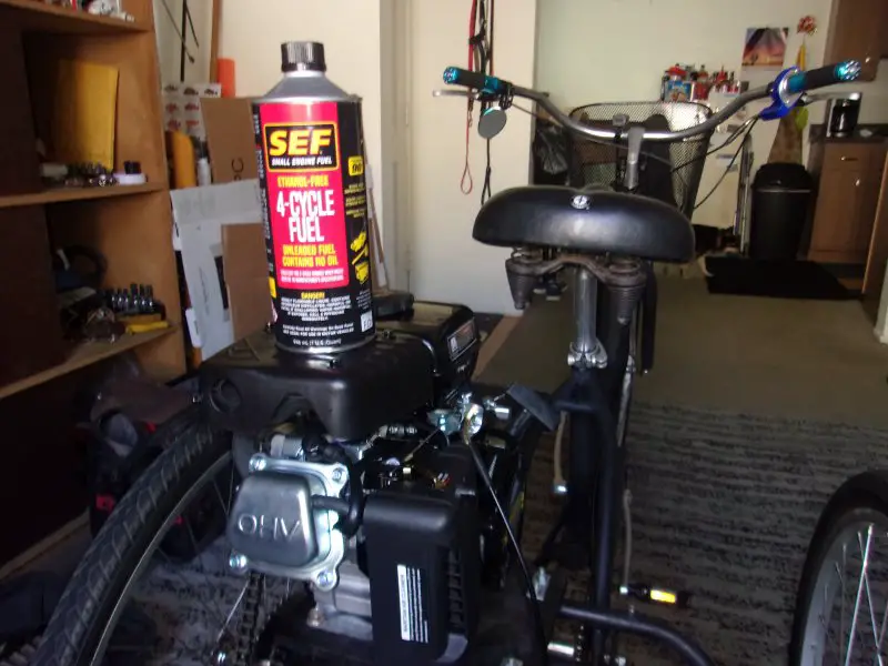

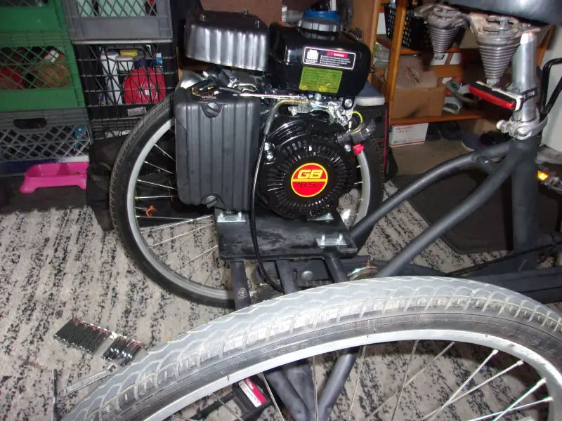

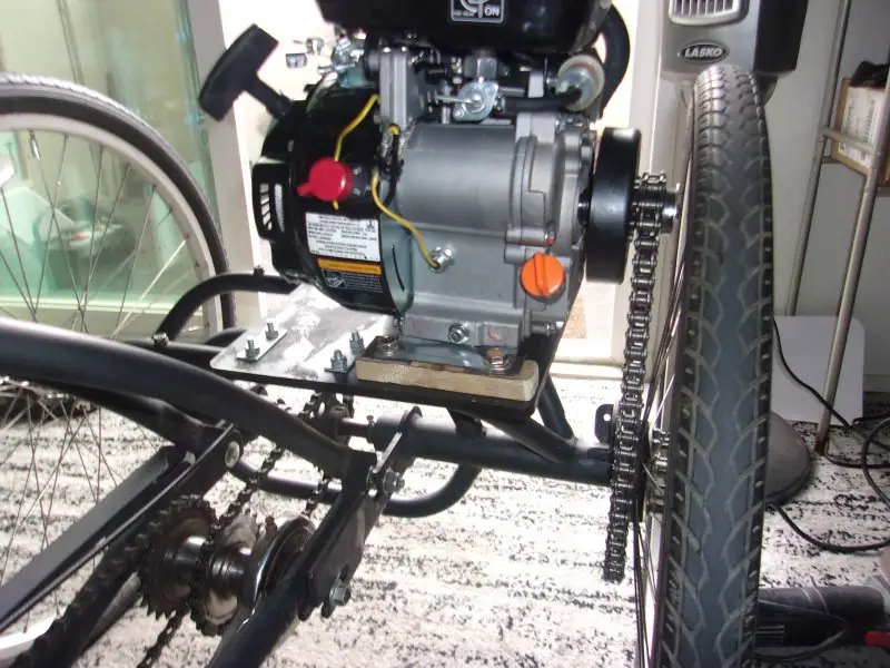

Major update. This was my first time ever putting together a gas bike and the place I bought motor from was no help at all. Me and my giant brained girl friend were looking at bike and she said the motor looks like its leaning forward and I had just read a post on here that said gas dont run uphill, Thanks to whoever said that
Busted out the tools and put a 3/4 inch block underneath the front of engine and low and behold its purring down the road. First pic you can see its leaning forward other pic shows new block and a level engine other pic is showing off my freekin expensive gas I got
Thanks for all info and help and I cant wait to try ethanol free gas. Many more questions to come cause I will be doing a 2 wheel bike next
