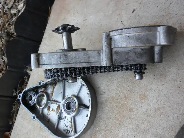

I heard a clacking and noisy sounds coming from the motor, and lost forward motion on the bike. It's a G5 Huasheng. I took of the cover of the transmission, and found 2 wave washers in the cover, of which one of them is bent and needs replacement. I removed the transmission and both shafts are terribly loose, wobbling all over the place. I called Bike Berry, and they don't think anything is wrong with the transmission. I feel that the transmission needs to be replaced. I started the motor and the clutch is working just like it is supposed to.
May I have some comments please???

Your output shaft bearing(s) is/are shot.
The shaft with the output sprocket is not true to the input shaft.
Yes, that is a hard failure.
I don't the 5G is the worst tranney, it at least has bearings on both shafts, the 7G only has an output shaft bearing.

You toasted your main bearings on the last one, oil the new ones up, they should all be oiled regularly.
