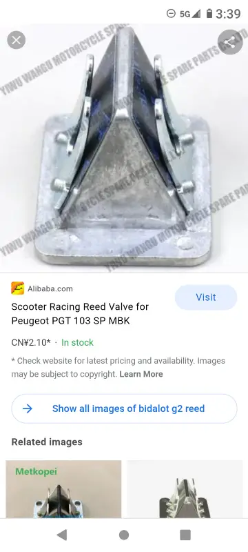

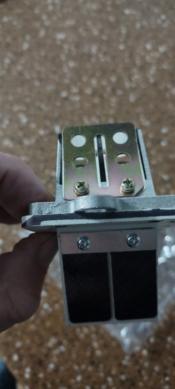

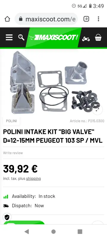

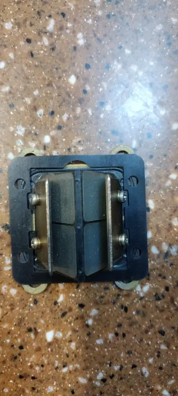

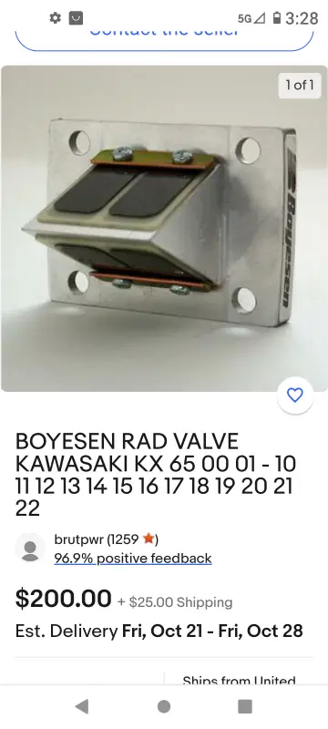

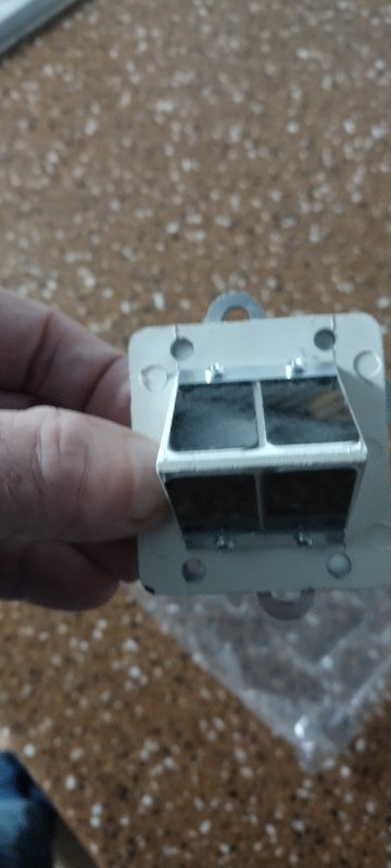

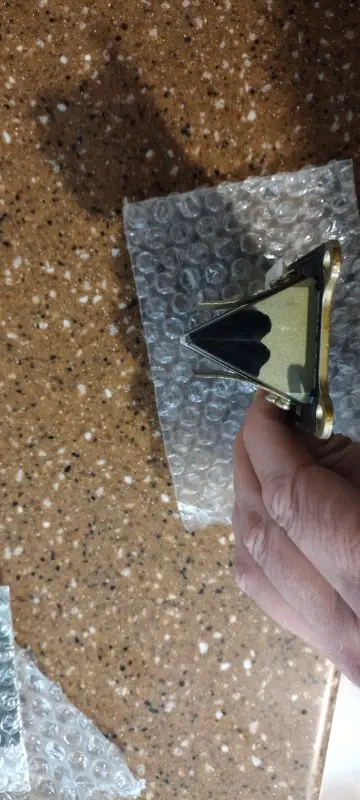

Wondering if anyone has used these parts to mod a G2 and if there compatible... Basically I want a metal cage and the stoppers... Or fab something similar

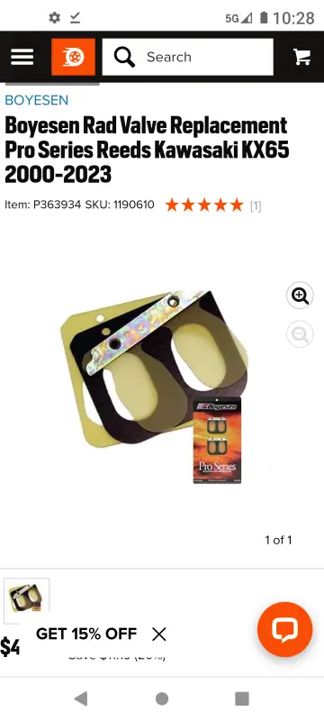

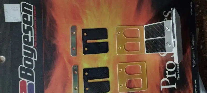

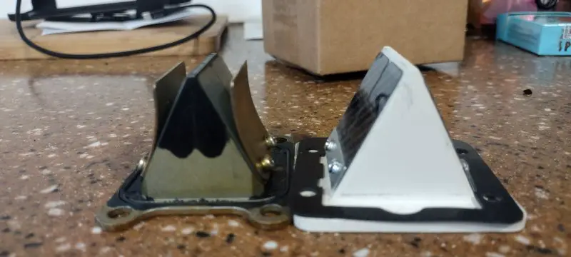

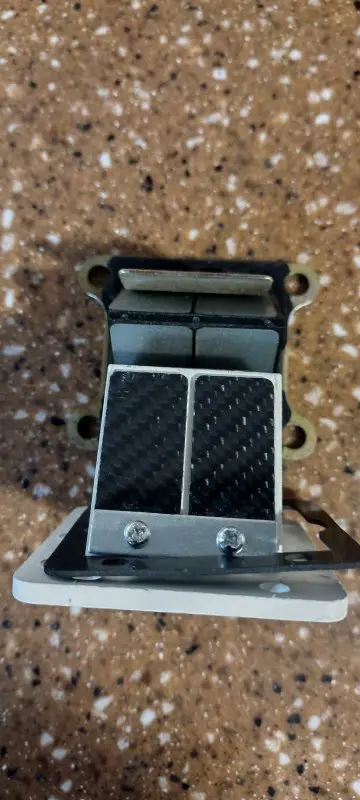

So I'm going to try kx65 to Dio... 3stage reed

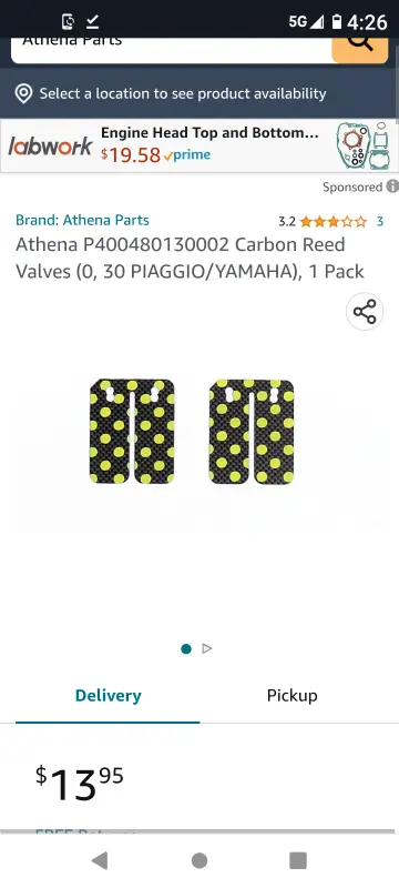

That first one might be a little 'flimsy' at high RPMs... The middle one looks better.
Fiber flap reeds are real good for bottom end but they can be 'fluttery' at high RPMs... (so I try to find ones that are thicker looking).
Metal flap reeds are terrible for bottom end but are very solid feeling at high RPMs.

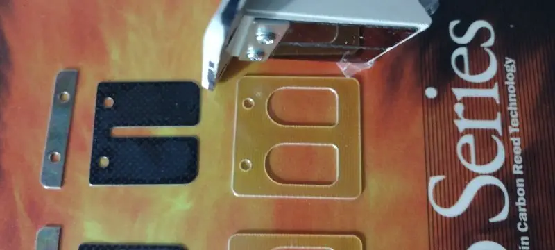

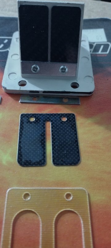

I have a set for 2stage blaster reed just useing the first stage on the g2... And I think you're right about the middle one... I'm just curious about compatibility if anyone has mixed up cages from something else... I'm planning on going through some trial and error...

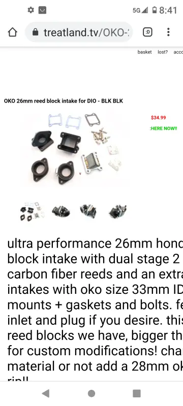

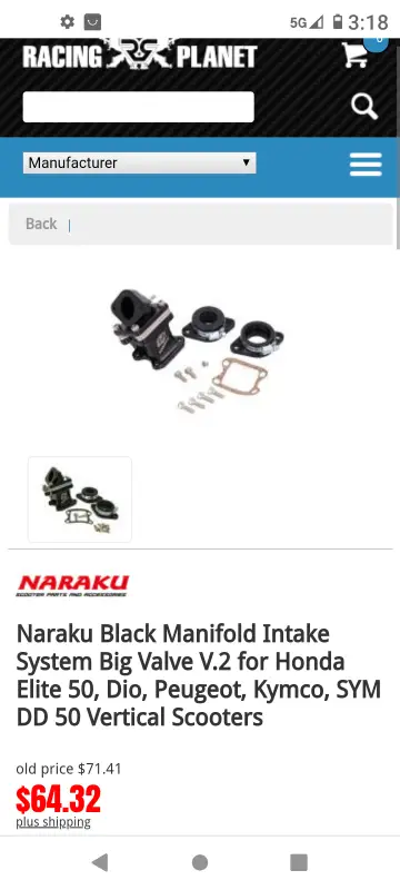

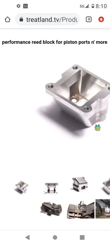

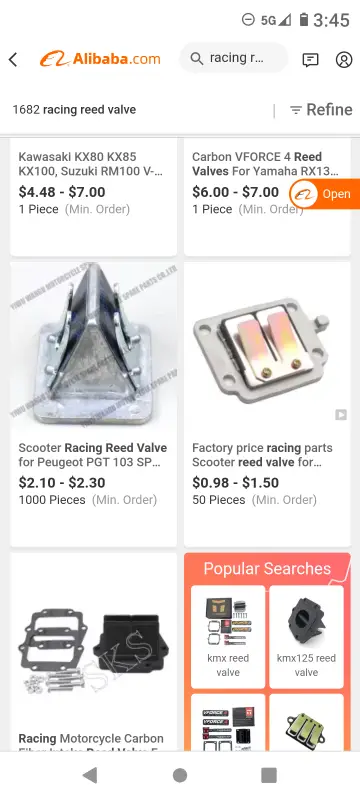

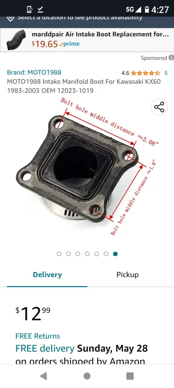

So treatland finally got the black Dio reed intake in stock... And I got this Dio adapter... 38mm bolt hole spacing that can get stretched and port matched...

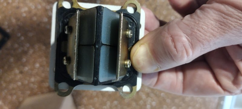

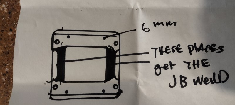

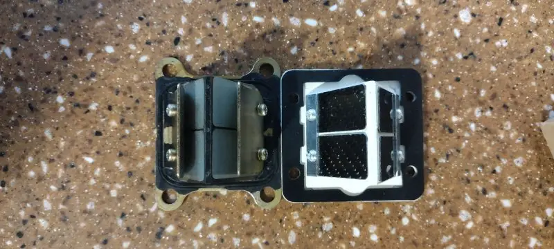

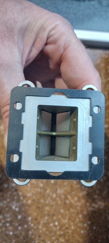

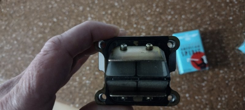

Just looking and comparing the kx 65 to the G2... Some reed box stuffing with some JB weld... Bigger 6mm studs on the G2 and I can run the boysen kx 65 reeds on the G2 but I really like the kx cage being real metal...

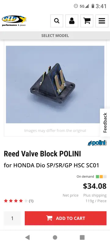

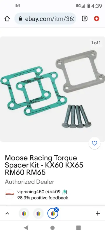

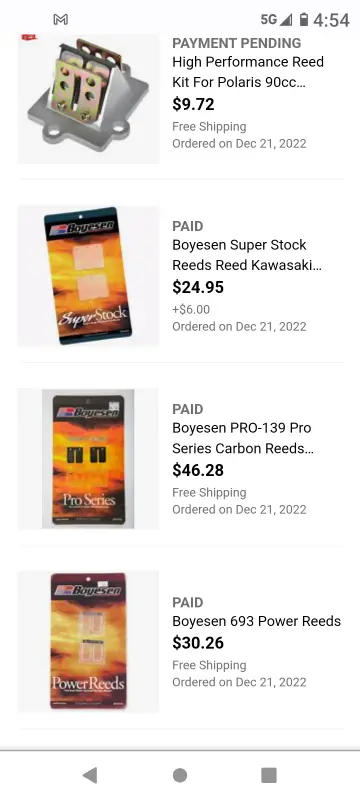

I found a possible stainless reed donor... Still enjoying collecting parts...

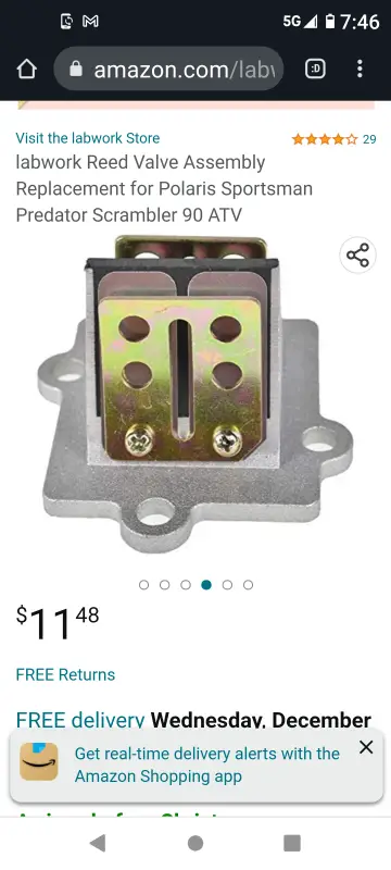

Now I know the kx65 and G2 are compatible... Figure I should throw some reeds at it... 2 types of dual stage a single stage a plastic blaster first of 2 stages and not Shure about the stainless Polaris 90 reed... And found a spacer that could be helpful for the next round... Can't really do much more without getting a bike running... So luckily I have exaust pipes to look at and more clutch parts to locate... Santa did good.... But for the shipping charges he's only getting one dry cookie with no milk...

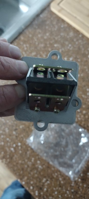

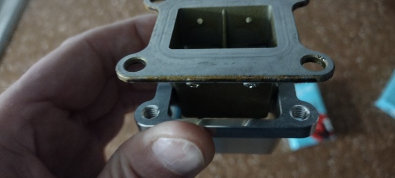

The Polaris 90 is going to work with little modification and the kx65 dual stage reeds will fit the G2 cage...

A little tight but the bolts line up perfectly kx65 to Honda Dio...
