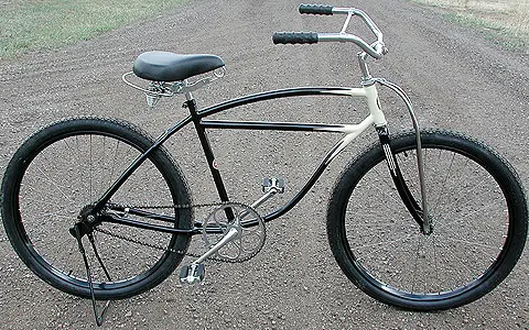

It just so happens that I went from the OCC R&D nitemare that I posted in this thread a long time ago, to a 26 inch raliegh BC! So I guess my answer would hafta be why couldn'tcha do it? Here look I'll try to get the pics
