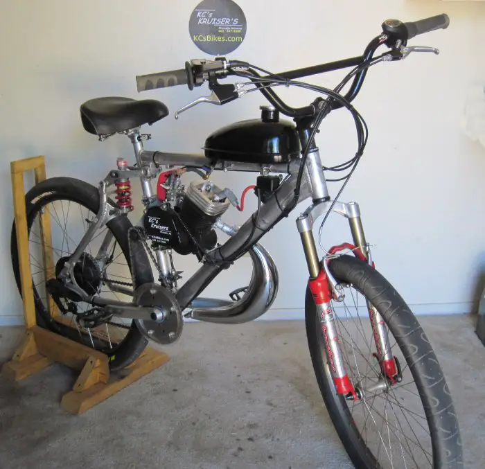

If you have a full suspension frame where the tension spring is behind the seat post then it's very doable. This bike was built by the Late KC Vale.

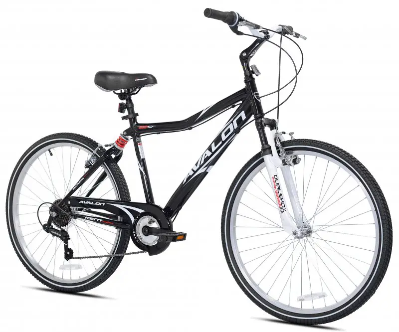

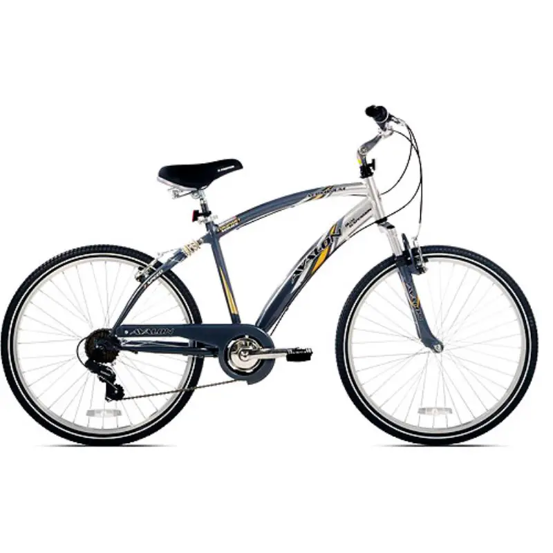

You can still buy an aluminium Kent bike whose tension spring is located behind the seat post.

Well my Schwinn Sidewinder cost $230 after taxes. That's what we do; we take inexpensive bikes and make them better. I think a couple of them are steel frames so they'd be easy to weld on.
