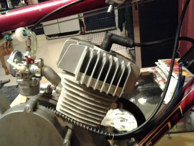

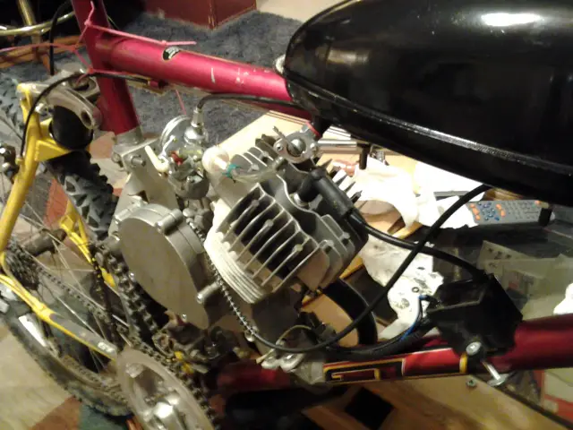

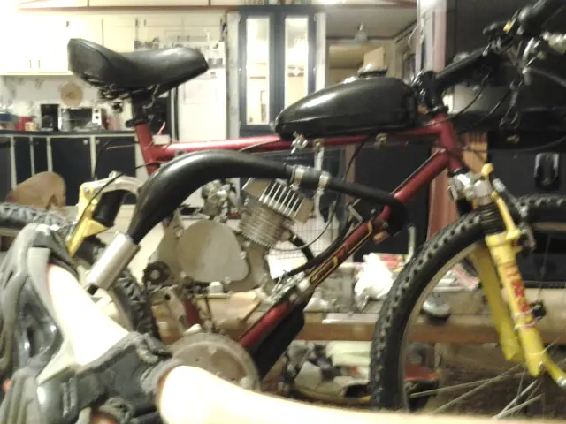

I got some more pics for my build. One is a mockup of the xpipe and then some pics of the Puch Hi Hi Head. Sorry my foot is in the way it wasnt holding it up like it looks just in the way.
The head unfortunatley does not have enough clearence for the piston. The piston hits the head but I going to try to double up the head gaskets to see if that helps. But then again It is very hard to start and I dont wanna ruin the freewheel on the shift kit trying to start it all the time.
Also I am glad that I changed the head or I would have never known that the stud came loose and one was stripped where the nut goes on. When I get paid I will get the head stud kit from sbp and lock tight them in. I gona order the 70cc Puch hihi head as well it has less compression but will provide the extra cooling that I am after for the slower parts of the Mt bike trails I like to ride.

PS I did temp mount the xpipe and take a test ride and there is a big difference in power and torque which will really help on hills.

Wow, I really like this build! you are keeping it clean and classy and I really respect that. In terms of the head, it's kinda a crap shoot but there are different thicknesses of gaskets on different engines. The other thing is, and this will REALLY help your performance, you should see if the piston is coming up really high in the exhaust port even when it is at its LOWEST point. This is not good for exhaust flow and if you make a spacer to put at the base of the cylinder you will correct the flow and simultaneously lower compression. In terms of your stripped stud hole, well, I've been there, and you really can't get away with loctite to hold a stud in a stripped hole. You can try JB weld but I've never had luck, the only thing I would use in that specific location is a helicoil, if you're gonna do it, do it right. And as for the pipe, enjoy it! it's an awesome pipe!

Interesting head swap, its a shame it didn't clear the piston.
Id go with thicker base and head gaskets made from dead soft annealed copper of the proper thickness.
These are easy to make from roofers copper flashing stock, just trace out a new gasket on the copper and break out the dremel tool.
I now use only copper head and base gaskets and still haven't blown one or had a leak yet.

cool thanks for the responses.The good thing is the stud it self is only stripped at the top where the nuts go to hold the head on. I got the sbp stud kit the other day and will be putting it in soon. I am gonna try making a thicker base gasket but I really dont want to remove the jug cause I have 2 huskies and no matter what I do I know there hair will end up in the motor. I dont have a shop and its to dusty to try it outside.
I think I may just order the 70cc head that will clear and put the 50cc on my cruiser where I dnt have to worry about the compression ruining the shift kit trying to start my gt cause it is impossible to start the gt without rolling it backwards first till it moves and then kicking the crap out of the pedal.

I got the stud kit in from SBP and installed it. Put the original head but on for now till I get enough money to purchase the 70cc Puch Hi compression head so the pinston will clear. Even with the extra base gasket and head gasket It will have to much compression for the shift kit to handle on starts.
I did however get the xpipe mounted on permetly and am now gonna start tuning it. I had to add an extra 45 copper elbow so it is to long by a few inches to make a difference yet. It actually slowed the bike down by 2 mph cuse it too long about 17in total length from header to chamber. I will shorten to about 13in first if I can and retune the carb to see if that helps.
