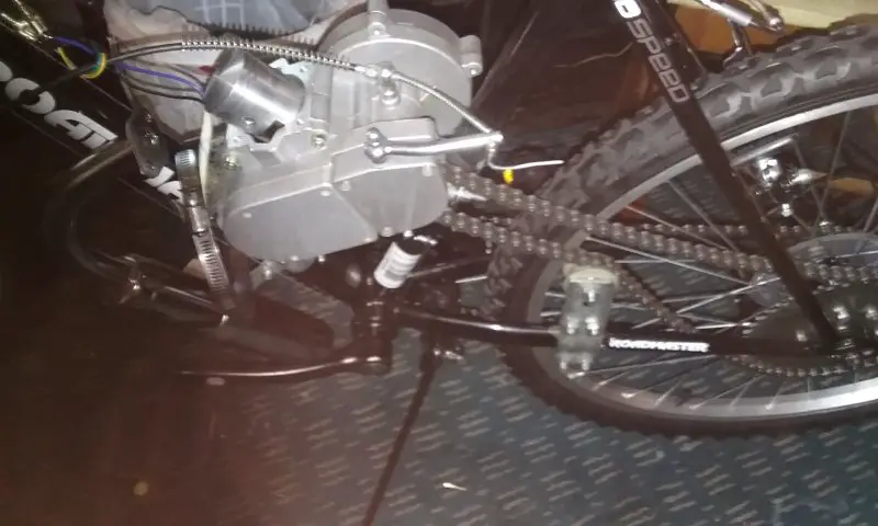

Some good pics of your engine setup on the bike may be helpful also, this way if someone notices an issue, they could pointnit out to help you know what you maybneed to do to get your bike setup right so you can ride it under engine power.

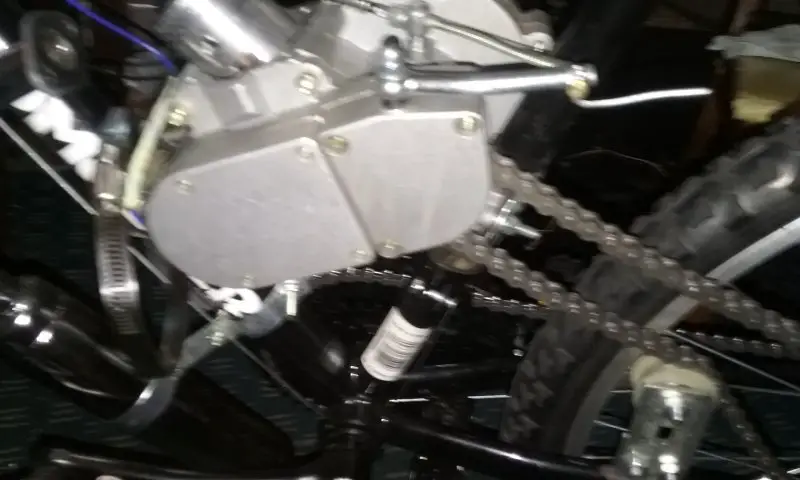

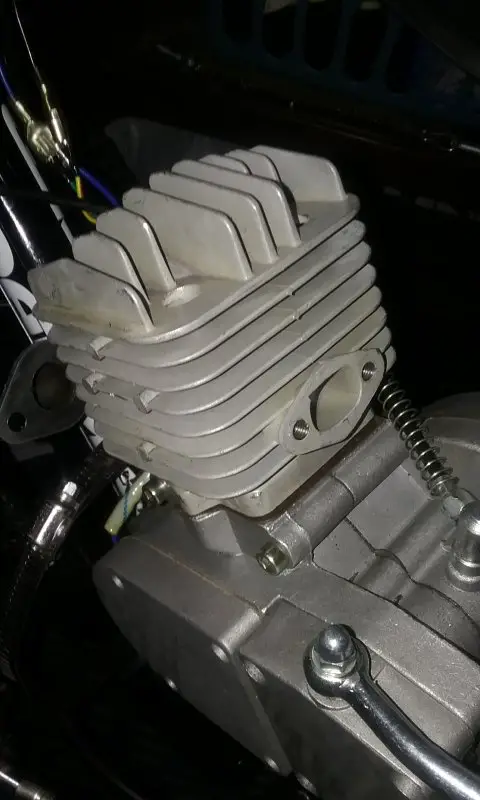

I'll put up pics but they are of the motor dissembled, although on the body.
Here the pics:
Motor:
Position of motor:
Other side of motor:

OK, based on what I believe I can see in your picks I believe your engine has the piston with lower wrist pin placement, so here is a very inexpensive kit that gives you some extra gaskets as well as new rings, piston and new wrist pin, so for less tyn $9 you get new rings plus some handy spare parts for later if you should need them.
