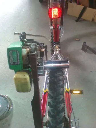

You mention easy build and affordable. I built my bike with an old weed eater I found in a trash pile and angle iron from a bed frame. Just one piece of iron holds it on the bike. BTW the bike was one someone was throwing away. I mounted a bmx peg on the motor for a friction drive. All I have in my motorized bike is $7 so far(fuel lines and spark plug). Although I plan changing some throttle cables later. I will post pics this weekend of the build. Alltogether I think it took three or four hours to build. You can see it here YouTube - Motorized Mountain Bike
Here are the pictures of my friction drive. I think this one is as simple as it can get. No welding, just bold it up and go. What do you think?

I like it and I have a few questions.
1. What size engine.
2. How good is it on hills.
3, Do you drag start it.
5. does it have a throttle. I have been debating if I want a throttle on my 25cc or not. I don't remember the last one being of much use since I ran it wide open all the time anyway getting it up for the next hill. The brakes seemed to work pretty good as a throttle.
I can hook up a 25cc solid like that but a 31cc I had to set so I could lift it to rope start.
I like to think of the 25cc that shuts down when it comes to a stop sign as a pure assist engine which is great. I am going to build another one of those to ride around getting some exercise.
The 31cc seems to pull the hills better but requires a lift mechanism to keep it from spinning on the tire.
The 33 chain saw engine I tried a few weeks ago did the same thing. I had to lift it to start it with it's reel starter, then lower it onto the wheel.
I am experimenting with a used tire cut and jb welded to the drive wheel. If that works it will solve a lot of our problems., It will get much better traction than the smooth metal wheels and it should not wear out like the heater hose some of us tried. As soon as the roads dry I'll give that a good work out.
1. The engine is somewhere between 21 and 25cc. It came off a weed eater xt200 (really old).
2. I'm in Florida so no hills, other than really small ones. I does ok if I have the speed up before reaching them.
3. I took the rope start off so the only way to start is drag starting. I thought about a lever to raise and lower but I opted for it directly on the tire.
4. I move the back brakes to the left hand side and ran a cable from the right hand brake lever to the throttle.
I have a ryobi engine on the way. I hope to have alot more power from it than the weedeater. So far the smooth friction drive hasn't given me any problem other than slipping when wet. I have some epoxy and sand to put on the shaft but havent got around to it yet.
