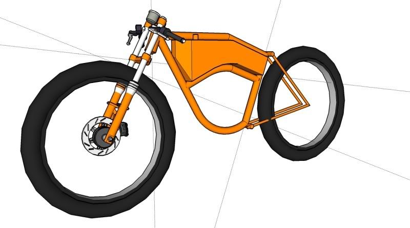

Havent made much progress at all, other than finally getting in our house. At least I have a shop again! Spent a little time tinkering on sketchup, grafted a set of wheels on my frame. Its rough, they came off of a Dream 50 model and then got resized so it looks kinda funny, but you get the idea.

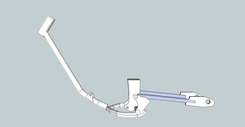

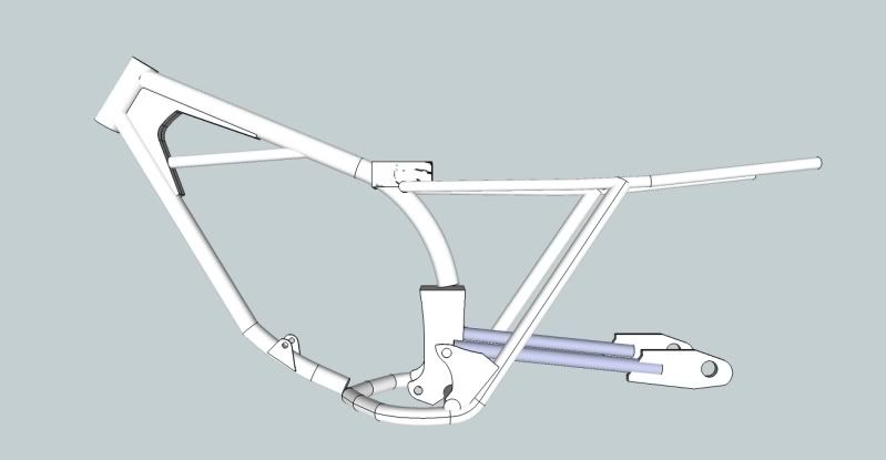

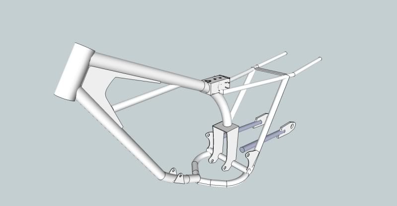

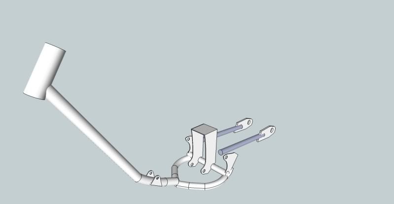

Man, sketchup is a pretty darn cool program. I discovered how to import pictures and build models over them, so I've been working on the XL frame. I dont think its anywhere close to accurate, but it gives me a lot better idea of what all I'm going to have to do...
Pick of the modeled XL frame:
Nuther Shot:
Built all that just to HACK It off!!!
And the problem I was kind of expecting.... The front wheel has some clearance issues. I plan on using the XL's stock front end or a CB450 front end, and a 23" honda rim, so it wont actually hit the frame but its going to change the way the bike sits for sure. Going to have to extend the swingarm a bit too I think... and I have no idea if its even close to scale with the picture.

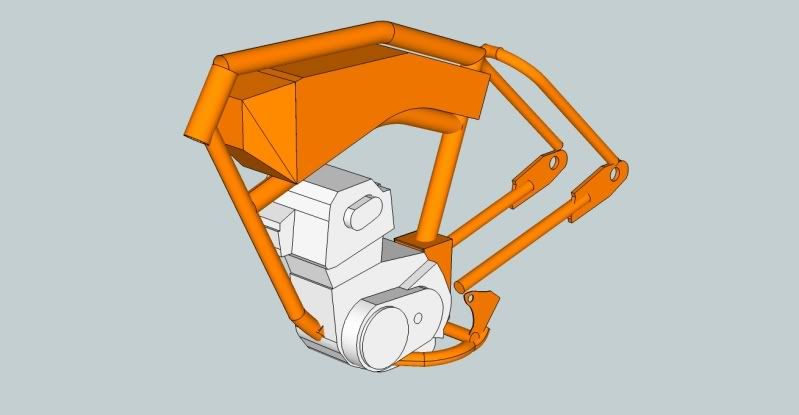

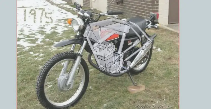

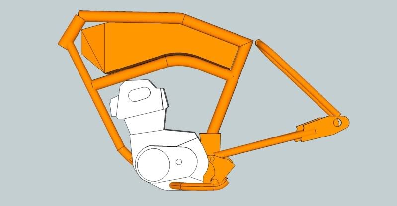

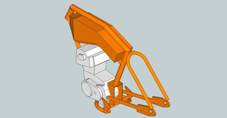

Played around a bit more today... Maybe I'll just have to be happy with 3D model of the thing. :cry Nah, I'll get to building it for real... Eventualy! :evil
Made a crappy engine and grafted the Merkel-esq frame on the top, and it turned out half decent. I think it will definately be do-able.
XLerkel over an XL pic:
And over the Merkel:
And a couple of "painted" pics of just the frame and engine:
