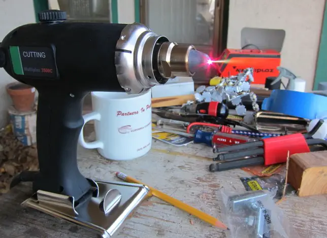

I have a Multiplaz 3500.
I like it. Very cool, purple plasma

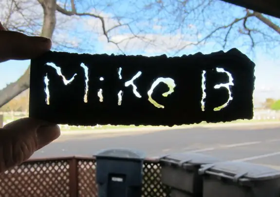

I wrote my name in 1/8" steel

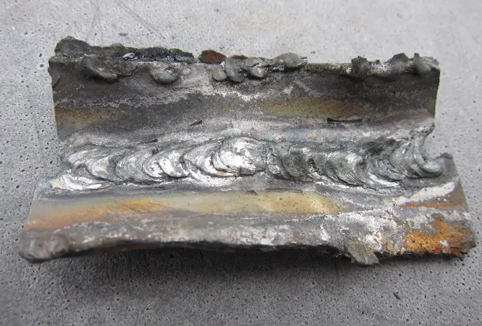

First weld in mode 2. The other crap was me not reading the manual and using just torch (mode 1) and getting a crappy surface weld.
Very strong, bent it inna U. It can braze too;
It really can do anything and it's so easy.

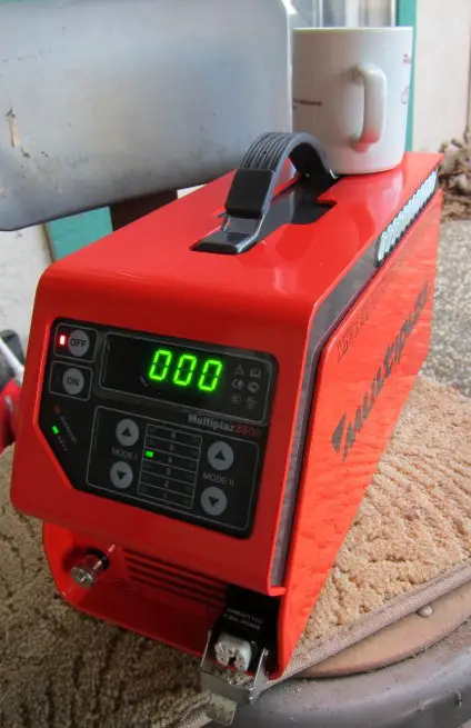

That's what you see when you plug it in. It's ready to rock, but no voltage to the torch. When you push the on button the torch powers up and then you start the torch by pushing the electrodes together. The voltage is adjusted by the same knob on the torch which varies the length of the arc inside the torch.
They give you extra electrodes with the kit when you buy it. I haven't had to change one yet, but I don't have 20 hours on it either. 20 hours of welding is a lot of welding.
