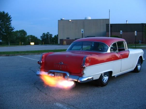

you think that's real? it's all in the movies man.
in order to shoot flames out of the exhaust (other than by the engine backfiring) is to have a flame thrower kit.
you have to have a coil and something to pulse the spark (like a magneto or a distributor.)
you have to kill the engine so raw gas goes into the cylinder(s) and is forced out the exhaust by the piston(s). the spark plug in the exhaust will ignite the raw fuel but the spark plug has to have a way to pulse just like it does when it's in the engine.
just hooking an extra cdi up won't work because as soon as you kill the engine to get raw gas into the cylinder, the extra cdi wil not fire. On top of that, the magneto may not have enough power to fire 2 plugs, and this extra plug in the exhaust would be firing while you ride....which will rob power from the engine spark plug and steal performance.
you can't just hook up a spark plug to the exhaust....it has to be hooked to a separate ignition system that works opposite from the engine ignition, you have to be able to switch back & forth from the engine ignition to the flame thrower ignition.
here's my car.
