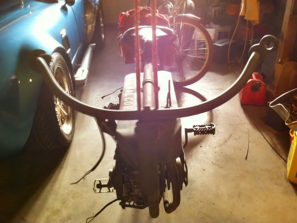

Here is a rough and dirty picture. The angle, 27-28 degrees, is spot on with what vintage motorcycles were back in the day. I have this great book you should look up, it's called "early motorcycles, construction, operation, and repair by Victor W. Page. Hundreds and hundreds of early schematics, drawings, and manuals from 100 years ago. Great tech info.

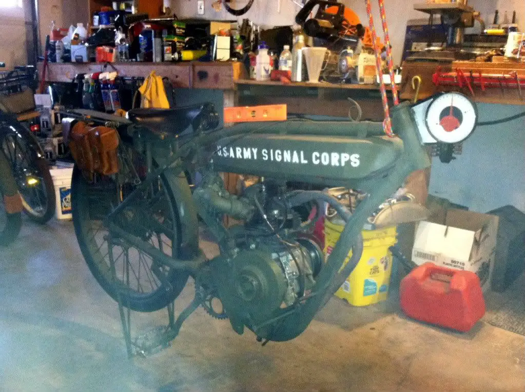

Here is the current state of affairs. Lots of dismantling. I ordered a new front fork and handlebars. I just need to wait for the parts to arrive.

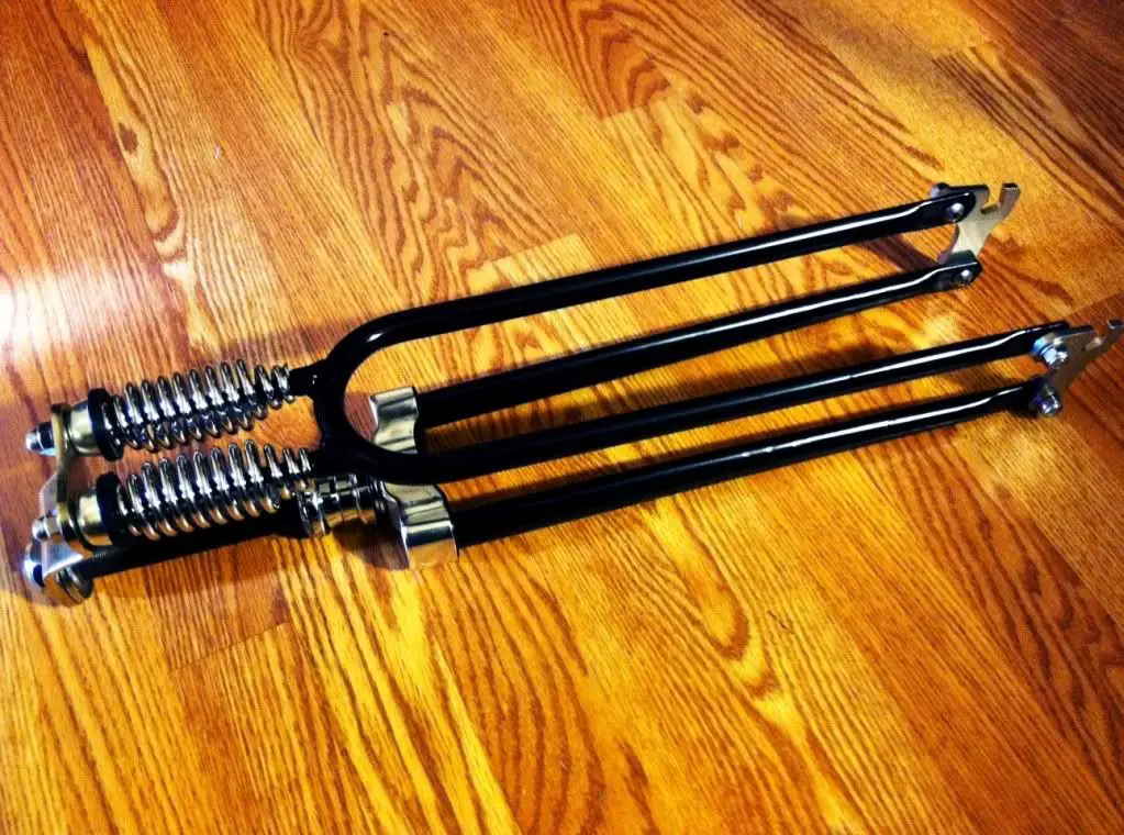

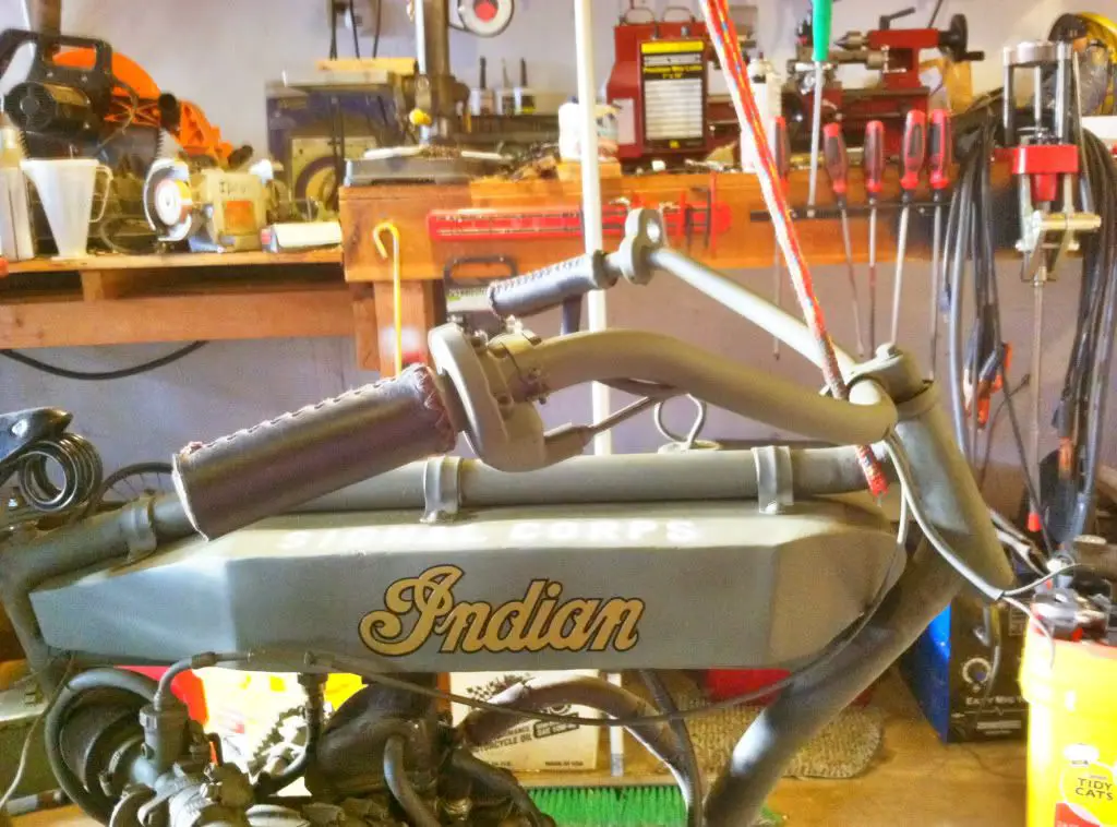

New parts arrived. I'm starting to put her together again.
New Monarch motorbike fork
New Felt extra wide handlebar
I changed the paint as well. Now the ARMY graphics are on the top of the tank and the Indian tank script is back on the sides (thank God)

I have the same bars and my kid just purchased some, they are nice and thick compared to others. You will be happy with em. The bike looks real good, I have one question? What size is your head tube?
The head tube is set up for 1 1/8" thread-less stems. I like to use 1" stems though. The work around is I run 1 1/8" sealed roller head bearings and then I put in 1" bearing cups which fit perfectly. The Monarch fork is 1" so this is what I did.

Nice, are those the beefed up monarks from sportsman flyer? I like how the Indian decal looks on the drab green.
Yes, these are the beefed up Monarchs. Heavier welds, thicker rockers, rockers mounted on the outside. I don't know the other differences. I like this fork because I can weld a headlamp mount to the top spring plate. It will look authentic. I'm also going to run a front fender with the fork. I think I'm going to steal it off of my Schwinn.

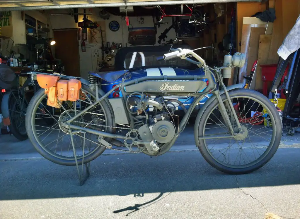

Well I pulled an All-Nighter and basically finished it. I really like the new stance. It rides very well. More predictable. This will be cool riding with my WW1 uniform and helmet.

Basically the steeper the rake, the quicker the steering, but you lose stability. Sporting bikes and motorcycles have steeper rakes.
The shallower the rake, the slower the steering, and you will gain stability. Bad for sport bikes but a more relaxed ride. I was running 15 degrees because I matched the steering rake from a bicycle I owned, a race bike. It was WAY TOO STEEP! :O
I measured the rake from the drawings in the motorcycle book and most of the bikes were running around 25-28 degrees rake. I made mine 27 degrees and I couldn't be happier. It is so nice being able to enter a turn and speed without having to fight the bar and use body english. It looks better too. I let me friend down the street ride my bike today down the street and the illusion is that much more believable that it is an old motorcycle because of the 80" length due to the extended rake. I'm all set for the A&S BMW Vintage Motorcycle show Sept 29th :)
