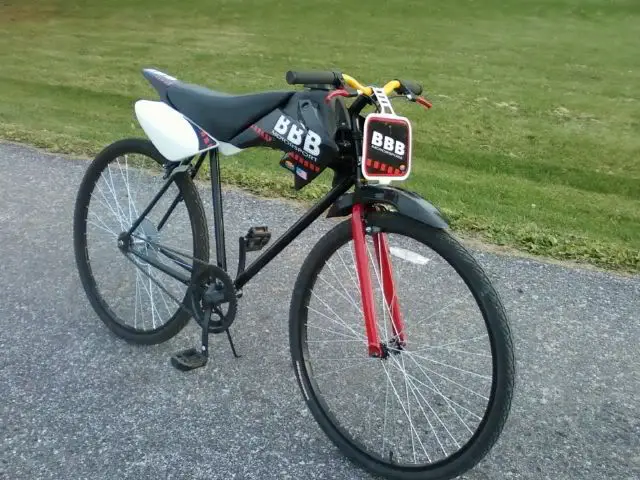

I guess it is a pretty decent bike after we went over every single bolt and spoke Everything and I mean EVERYTHING was loose so I make him buy some red thread locker and we went to town . Now lets see how the welds hold up after some China girl good vibrations
yes. thats how it's done. i used a boring bar on my mill to enlarge the center about .030" so it fit over the flange of the fixe sprocket. if you took your time it could be done with a half round file or a die grinder.

.welp,the bike arrived with a flat back tire an unrepairable hole in the tube.fixed that and put a flame web springer seat on it.looks right at home.can not get this fixed gear sprocket off for anything.any advice would be appreciated.
nope.I think I'm gonna put a shimano coaster brake hub on it latter when I ad a motor.Just gonna leave it a normal bike for now anyway.I'm afraid I dont have the right tools or know how to get it off without braking the wheel.
the outer jam nut is left hand thread, turn it cw to take it off. the sprocket is normal right hand thread, turn it ccw to take it off, the hub is stepped, the nut and sprocket are different sized threads.

I'm in the process of building up this same bike. Just gotta mount up my rear sprocket and gas tank and its basically complete..
