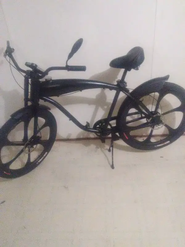

I have questions about the Fito Modena GT-2 Beach Cruiser Bike.
154805012331502018-main-jpeg.101333
It is advertised as a 26" Mens Beach Cruiser Bike But the wheels are listed as Kenda 24"X3" high profile wide tire. tire diameter: 26". Would a standard 26" wheel work? I am thinking about reusing my mag rims with 2.5" tires.

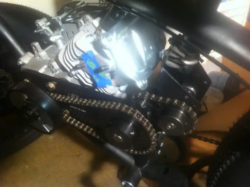

Do you think a 79cc predator engine will fit into this frame. I searched Google and found a similar build but not sure if it is the same frame.
Wayne I built two 2 cycle builds using this frame and it's a durable frame one was steel and the other aluminum. Good riding bikes.
The video looks like the 4 cycle fits well. If that's the motor you're talking about. I mounted both bikes gas tanks behind the saddle...much cleaner look.

Thank you for your firsthand knowledge. Do you think a normal 26" wheel would fit this bike?
dd
Yes Wayne the 26" wheel and tire fit. I also did away with the Fito 24" x 3" tire and wheels.
Though the Fito comes with 24" diameter wheels the fat 3" tires stand 26" high just like the 26" wheel mounted with a full size cruiser tire, usually 1.95" or up to 2.5"' wide. 26" wheels with 3" tires mounted stand 28" and those won't fit.

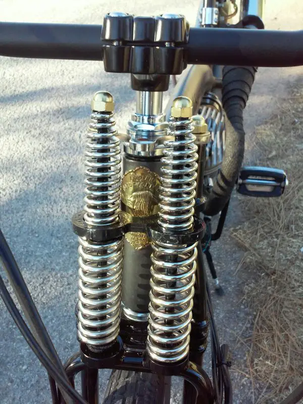

Let's get back to your original questions. The 26" wheels first. Look at the photos I'm posting all three show a Fito Modena with 26" wheels and 2.5" tires mounted they work. I ride this bike and built it. I built another Fito Modena for my daughter in law and put 26" x 2.00" tires on it & it works as well, One photo I'm posting shows the ORIGINAL Modena fork being used with the 26" wheel and tire. The other 2 photos show the Fito Modena (same bike just a different fork) with a 4 spring fork and it also works with a 26" tire mounted. If you use the same wheels shown on the bike used as your image posted with your user name and they are 26" they will work as well. The answer to your question is "26" tires work". The photos prove it works.
Will the motor you mentioned, the little 79cc Predator work in the Fito Modena frame without major surgery?. I don't know, but the tires & wheels will and do work well!
The Fito Modena is also offered as a single speed bike as well. The bike shown in the photos works really well and pedals smooth too.
Rick C..

Moved all of the Fito parts to my gas tank frame. The gas tank frame may be a cleaner look.
Copying a sick bike parts kit build found on-line. The kit gives me engine mount, wide pedal crank, frees up my rear wheel to run disc and eliminates the engine side chain tensioner
