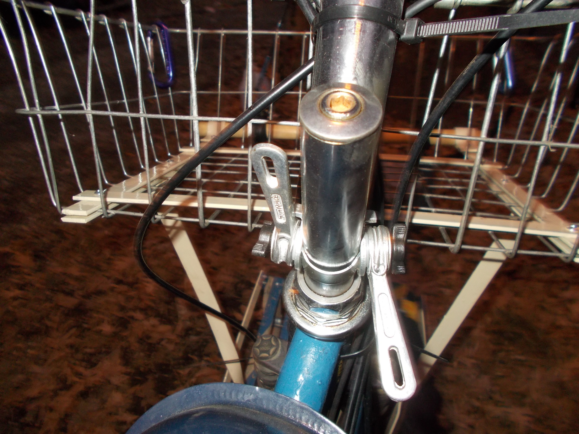

But I found having no top tube up above the engine gave me no anchor point for the choke cable. It was just too sloppy. So I removed that cable and mounted a ground and drilled dime on the stock choke lever.
But now I'm going to have to make the choke cable arrangement work. It won't be hard, really. I'll just make a bracket that holds onto the seat tube and reaches out over the carb. That'll give me a nice, stable platform for the choke cable and it's sheath.
