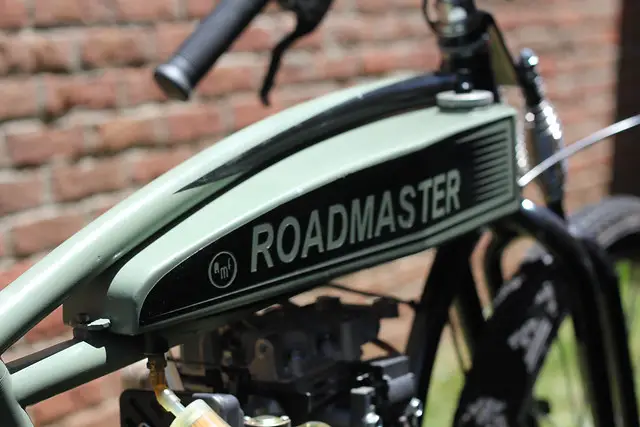

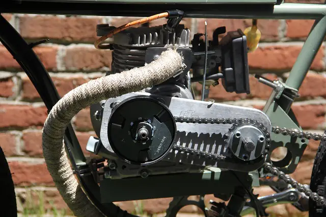

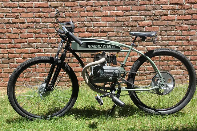

Without further ado, here are some pictures of it….
It's actually out of commission right now because I broke some spokes when my hub adaptor bolts vibrated loose. You can also see in the pictures that my coaster brake arm bent all the way around. Had the LBS install some new spokes just haven't had time to put it back on.

Dan, I'm more worried about the open chain from the clutch to jackshaft on the other side than the rope pull. The rope pull has a lot less to get snagged on since it's pretty smooth.
I'm running a jackshaft with no cover on the same engine, it's never caught my pantlegs. I have felt my bare legs get close to the clutch drum when wearing shorts, but it's never hurt me. A more serious problem, which you've already addressed, is the heat from the exhaust. I just ordered 5 feet of exhaust wrap from treatland. They sell it by the foot for $1.60 a foot and it's black. As soon as it gets here I'm gonna wrap mine and then I won't need to worry about burning my legs anymore. In pants I'm fine, but in shorts I can really feel the heat.

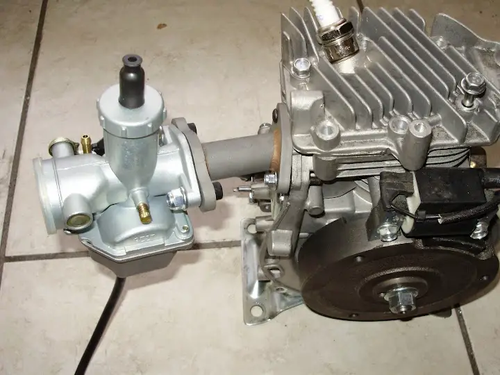

Swapping a cable ready carb on to that engine is simple. Either the NT or RT on a round manifold, or a PZ style on a flange intake
Either carb works better than the original unit, and a standard throttle cable fits.

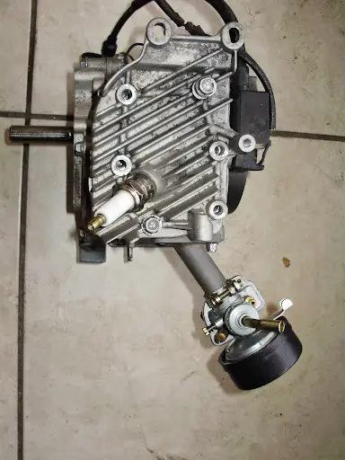

No linkage required with either carburetor. The standard China Girl cable snaps right in.
The manifolds are production parts, listed here:
http://motorbicycling.com/showthread.php?t=55050
