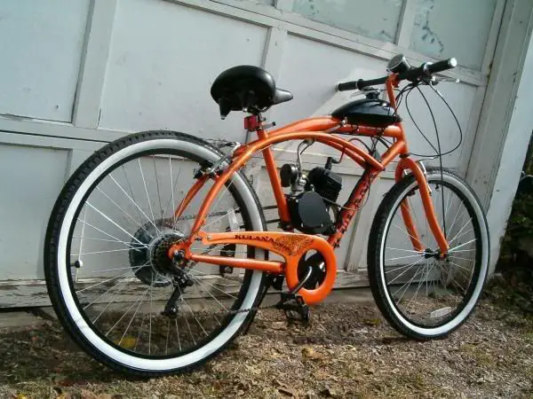

This was how it looked when I built it 6 yrs and 700 miles ago. Still needed to tie the cables down in this pic. I put a speed carb on changed to a 40 tooth sprocket on, ported the intake/exhaust and cut the pipe inside the exhaust off even to get better flow. Got up to 43 mph according to mobile police radar station. I just built it to beat my buddies bike that had a 3spd and a nitrous kit. I was building a nitrous kitted bike with a 7sp in case this one didn't do it , but it did ha. I let my son ride it and he put it in a ditch bending both rims so I started on the fat tire project.

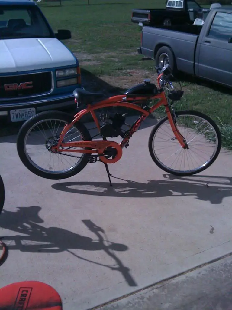

Sorry to hijack your thread but I have the same bike Insomniac. How does it hold up? Check mine out! I run a 2.5 inch tire with no contact with the chain, Where did you find a 24 x 3 tire? That seems like it would be a good setup. Nice bike
