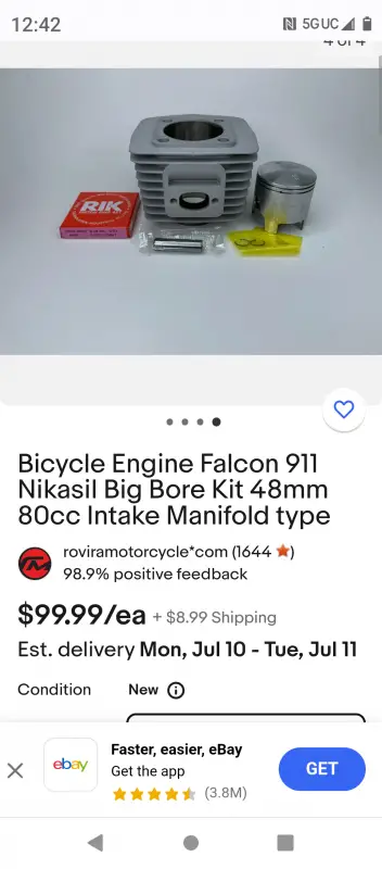

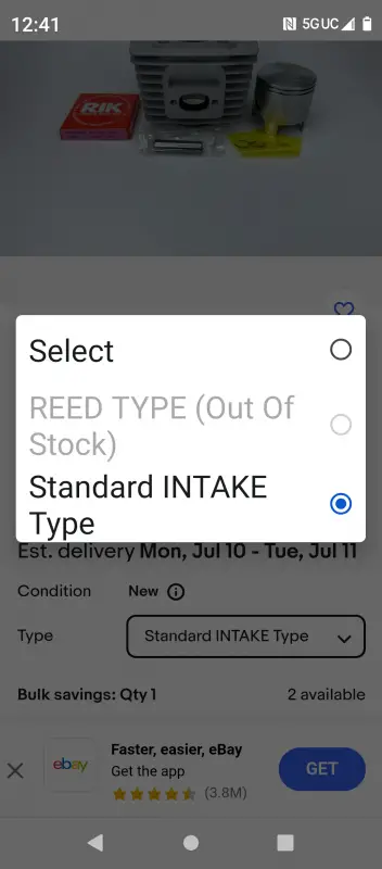

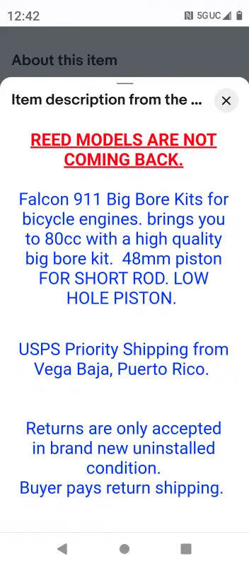

The reed is discounted... Like so many other things... The non reed piston port cylinder is promising... Could still window and reed block it... 3rd transfer etc... I might get some more of those...

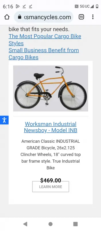

I don't like those Cranbrook for the same reason... And there small compared to an Electra or micargi I'm used to... I'm eventually going to make my own frame from 4150 tubes using the old frames as a template for the jigs... Then I can put the original together so no bicycle was harmed... That way I'm just buying stock and not hunting down frames... 16ga heavy weight frame
I'm going to get two of these at some point and motorize one of them

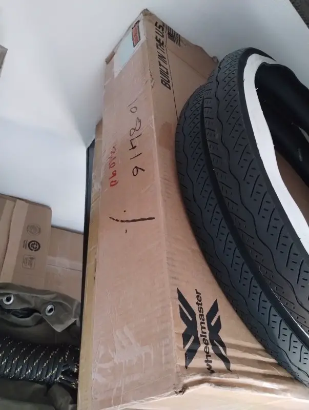

I'm done with AliExpress mostly carburetors and kits to tune them... It's a gold mine for that but everything else is cheaper and quicker to get here on ebay and amazon so it's not worth it... My wheel masters came in and there in wheel masters box... So there legit... But I fear wheel master has shut down and amazon bought up the remaining stock and there going to be done... You have to build a wheel from parts to get a 12ga steel wheel what a shamano 110 and I'm buying up 165mm+ forged axles when I see them... The made in USA stuff...

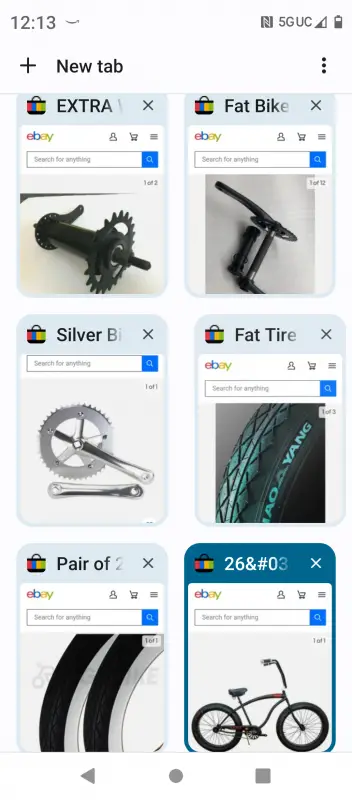

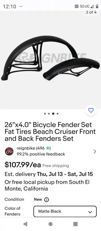

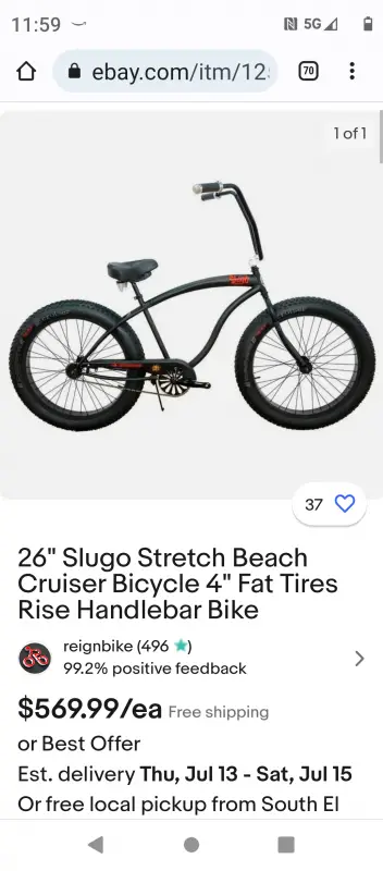

I've been studying up on fat tire bikes to find a frame for the leaf spring fork ... I can get the bike and all the replacement parts from one place so I'm probably going to get the micargi sluggo at some point....
