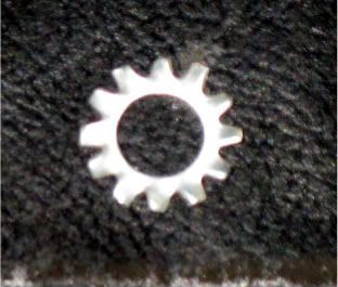

There's lock washers with "teeth" on the inside that bite into the steel of the dropouts, there's one's made specifically for bikes ofc and you may have them... but they just might be made poorly. I can't seem to find a pic and sorry, I just don't feel like takin a bike apart ATM lol - but even something like these (only larger ofc heh) would help should you not be able to find the bike ones;
While commonly available at any hardware store - the only problem with that type is they're disposable - you really outa replace them each time you mess w/em - but they'll getcha by till you can get the proper bike axle type ;)

like BA says, do you have star washers, or any washers at all? i put a thin washer on the inside, and a thicker, serrated washer on the outside, the kind bikes used to come with.

It's raining right now so I can't exactly test out my current modification (locktite on the axle thread) however, if that doesn't work out I will put on some star washers.
