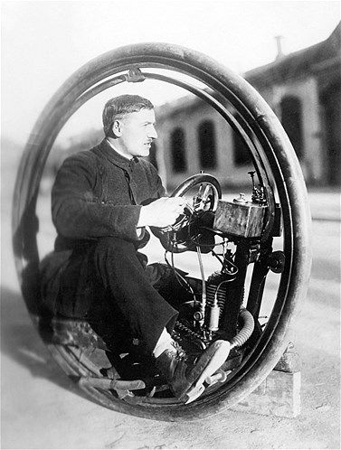

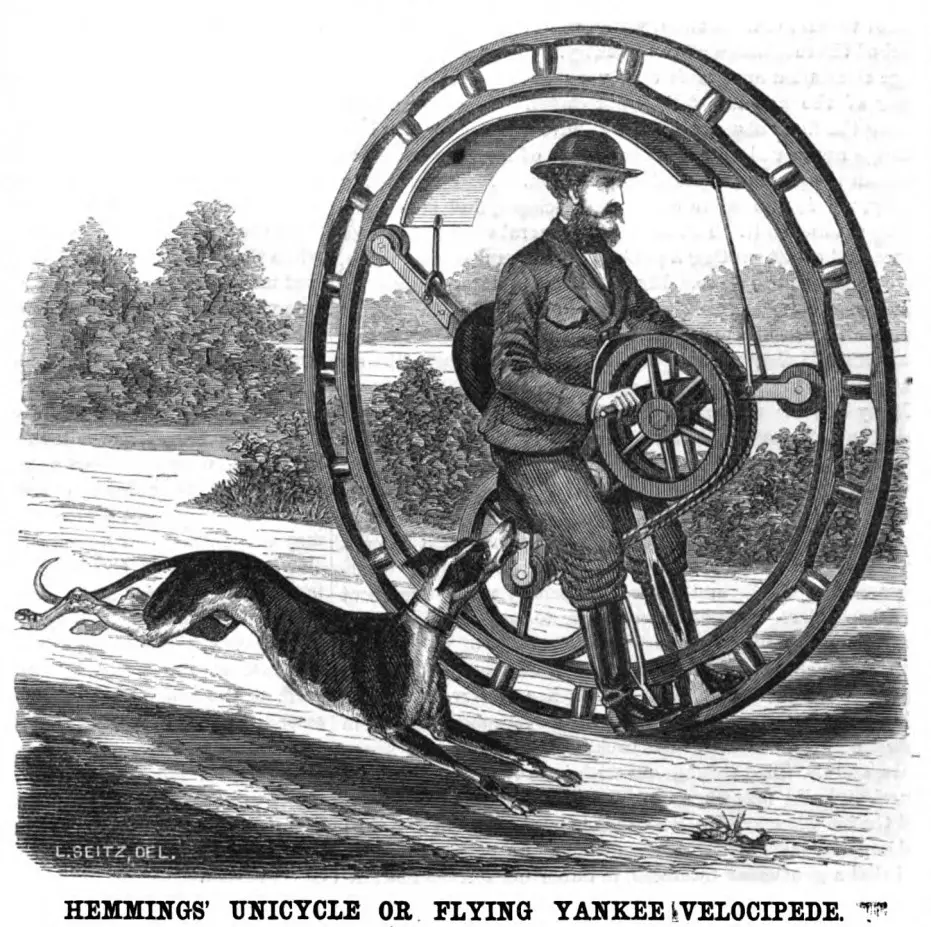

I would love to build a motorized version of this (pictured bike).
However the drawback is, as I see it the acceleration and breaking are limited by the total weight of the rider + weight of the drive system. If you exceed that weight you will be rotating with the outer wheel.
So steep hills(without creeping) & fast stops would be impossable. Would be cool for shows & parades but other than that pretty much useless.
Any contrary input, as I would like to build one!

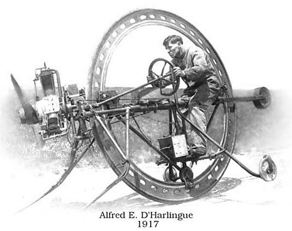

I vote for the one with the airplane propeller!!
All kidding aside, if you could find an old Segway, you might be able to use the stability control to make it easier to not 'roll' within the outer loop...........
They're called mono wheels or mono cycles....there's videos on YouTube etc. you realize if you spin a top fast enough...and that things pretty big ,so even more so...you won't be able to e erg enough to change it. An example...hold a front rim ant tire by the axle and spin...turning gets harder fast as you increase the speed.
As I remember and i could be wrong the inventor of the McLean Wheel was injured pretty bad in a accident in that or a similar contraption. I vote for propeller and a winged monocycle. For that matter, a flying motorized bike sounds downright fun too, one china girl for propeller and one for proper and fast runway speed using the back wheel.
Some good input, but no answers! Also wondering if a gyroscopic mechanisim could be incorperated to counter the acceleration/ breaking flaw?
All that's needed is a small-wheeled outrigger in front to prohibit over-rotation during braking. I see no reason why a mechanism couldn't be incorporated which would extend such an outrigger based on chassis-angle.
Do it.
But be careful and be aware there is most likely a REASON you don't see them around since it's clearly nothing new.
But just because it's not practical doesn't mean it can't be a hoot to build and play with.....
I had thought of that also and have seen a few variations of thattype of setup. However "IHO " it takes away from from the whole look.
Secondly the braking wheel or skid would need to be far forward to keep the main wheel from lifting (similar to locking up your front brake) or at least losing traction & control in a quick stop.
Dosen't seem to be a good answer to the problem or the MONO-CYCLE would still be around today.
An anti-lock braking mechanism would alleviate that issue. Come to think of it, an anti-lock system would also eliminate the need for the outrigger. Anti-lock => anti-roll.
I may be a bit slow on the uptake but don't see how that will help you make a quick stop, or fast acceleration?
I am not being sarcastic, as I would be very interseted over comming this problem.
