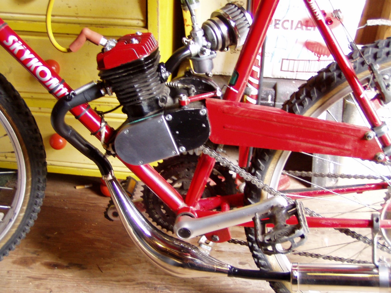

I've been experimenting with different ex-chambers and mufflers, just
to see for myself what the results would be.So far I've had a total of 6
different exhaust pipes mounted to my bike. Here are 3 of the expansion
chambers that I've tested. So far the best one has been the short pipe,
followed closely by the rear mounted ex-chamber. I'm really surprised
how sensitive this 67cc motor (engine) is to various mufflers (4) and
different applications of pipe length, muffler back pressure, expansion
chamber location and type. I'm going to try 2 more ex-chambers in the
next 2 weeks, and I'll post some new pics and results. It sure is much
more complicated than I expected, and very time consuming due to
replacing and resetting the Mikuni 18 mm carb needle positions, main
jets and pilot jets. But it it is interesting and fun too.

Good stuff. I'm thinking pic #1 would not add much perf, if at all. But are you saying this is the best? (cornfused) How did you measure?

Pablo, the best exh. pipe so far is the shortest one. A very close 2nd is the
long 1/2" pipe with the ex-chamber and stinger on the end. I don't know
why it works so well, but I am checking the speed and rpm with a digital
tach and digital speedo, plus I calibrate the speedo to a fixed traffic radar
sign that lights up with big LED numbers indicating your oncoming speed.
Plus the general acceleration from a 6 foot pedal start.I'm measuring the
pipes to fit the frame and using what I call a " By guess and by golly " trial
and error. I have yet to try two more ex-chambers. One that will go up and
mount just below and to the left of the gas tank and route past the seat.It's
made by SCSW. The other is very similar to the long pipe set-up. Anyway, I
will try as many variations as I can fit to my bike. It looks like I'll have to
remove my center stand to get the proper set-up.

Well remember how the chambers work. The engine end cone is twice as long as the muffler end cone. There is usually a straight center section between them. The exhaust sound wave expands down the initial cone then back to the rear cone where it is reflected back towards the motor. The idea is for the wave to reach the exhaust port in the cylinder just before the piston closes the port. Kinda stuffing some exhaust and energy back into the cylinder just before compression as the exhaust port is last to close. Just opening up the restrictive exhaust is a big help but when you get the header length close so the timing is right is when you'll hear the exhaust note and power really change. It will get a ring, ding, ding, ding. Just like a small dirt bike.

Here's the latest performance test results of all the different types of
exhaust systems that I tried. Without a shadow of doubt, the best
performance gain along with smooth mid range power is the expansion
chamber made by SCSW. It is a top mount system which allows me to
retain my center stand, which I preferred to keep. I had to solder my
#70 main jet, and re-drill it to about a #60 jet size for the Mikuni 18mm
carb. Now, it has a smooth transition of power from 5-35 mph! Excellent
acceleration too!
