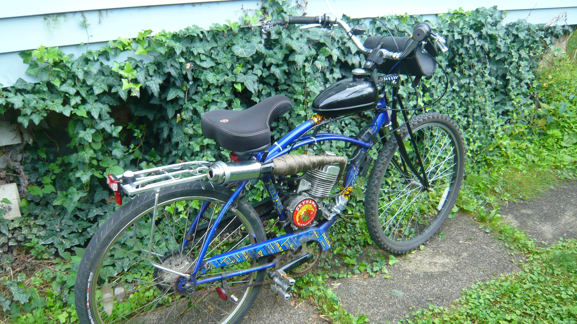

There is a big selection and good prices on eBay. If you have not done it before it's a bit of a tedious process but some builds where the exhaust comes close to your leg or body it can be a must.
just guessing here that for bikes that do a lot of short trips, the wrap may help keep the muffler from clogging
