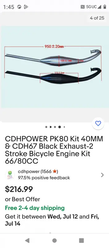

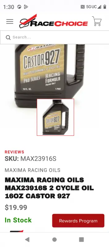

This is the oil... Top shelf... 32:1 on the china doll.. the performance builds 24:1 minimum... 16:1 break in... A 2 stroke is happy oiled up like a pig... Just get another exhaust or soak the plugged one in alcohol... If we're talking the kit muffler
Drill a hole it so it can drip on a new one..

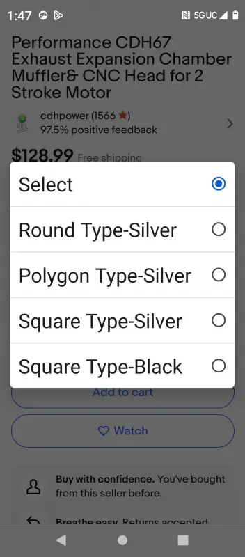

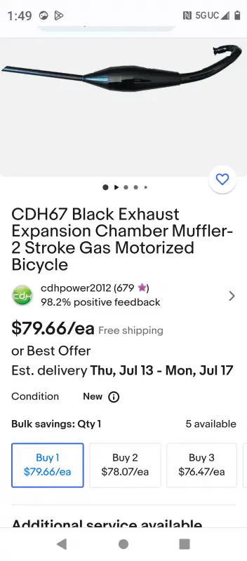

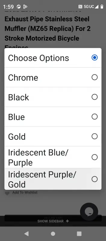

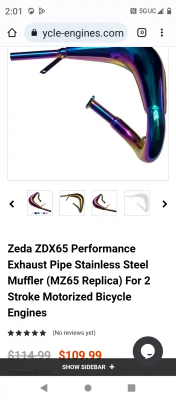

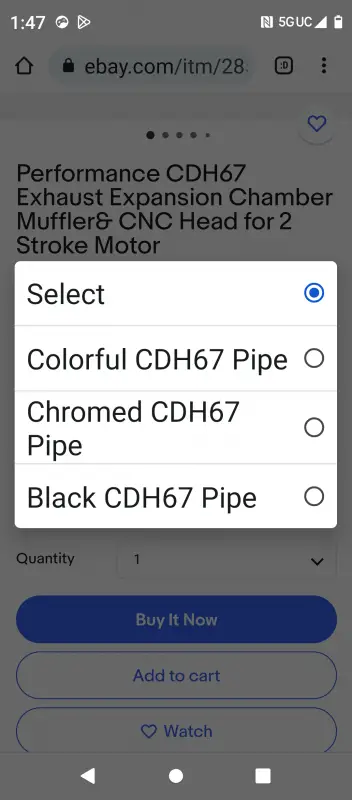

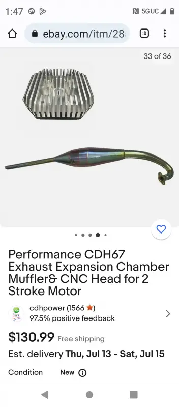

So I looked at what's available...
CDH power has a package from the looks
of it put some science into the expansion chamber... I'm going to get one of these with the head zeda has a similar thing going on also
