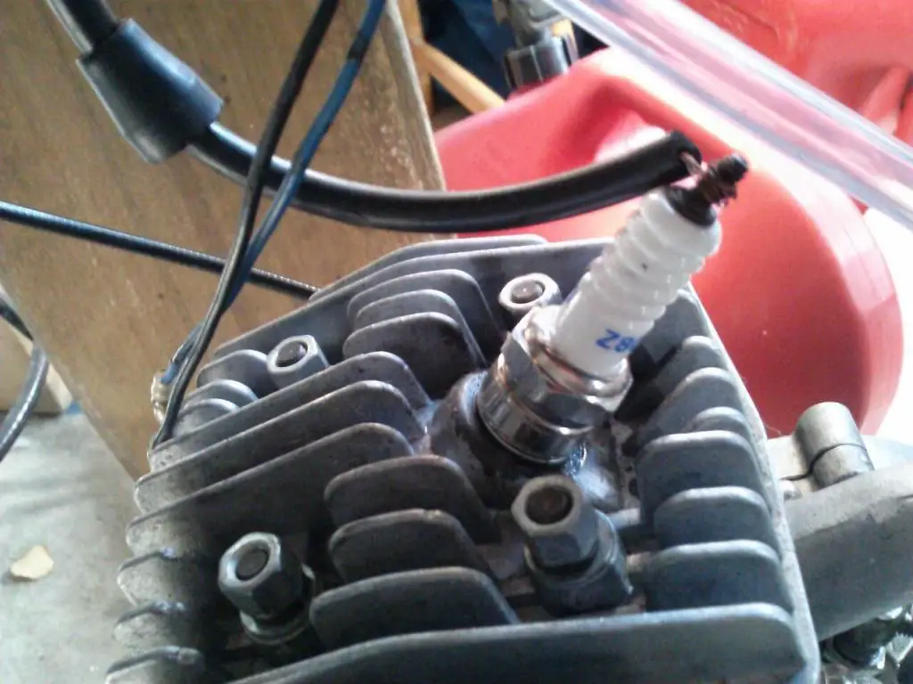

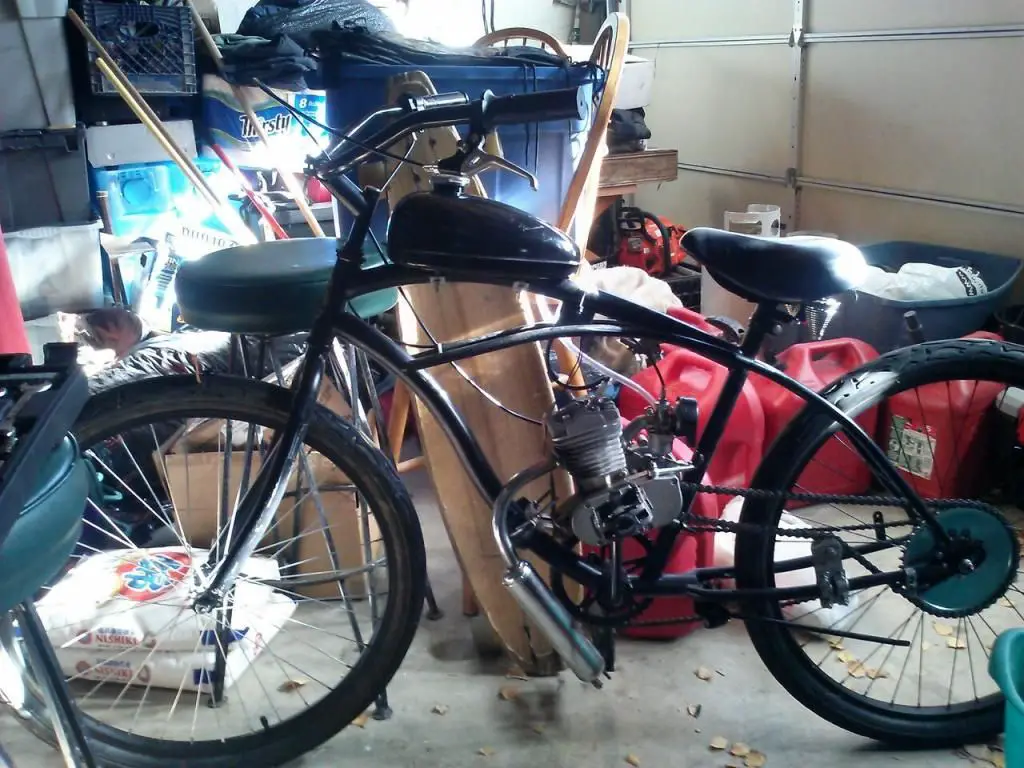

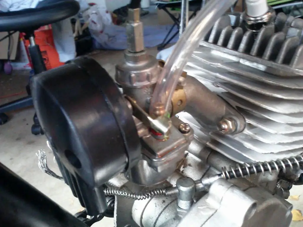

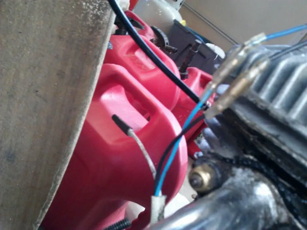

Alright if you need more intricate pictures just say when.
Bike itself:
Carborator:
Spark Plug:
Lines:
Nice looking bike, Timo.
A fuel filter would be a good thing, yes. You'd be surprised at how much gunk there can be floating around in the bottom of the tank. With the fuel line off the carb, how does the flow look if you open the petcock? And while I'm thinking fuel delivery, have you pulled and checked your spark plug after trying to start to see if the end is wet?
I'm not a fan of where your CDI is mounted, but only because your magneto wires are way too close to the engine.. if they rub on it when it gets got, the insulation will melt and they will short out. At the least, they'll shut you down. Many will tell you to lose the quick connectors and solder the blue and black wires together, too. The stripped plug wire wrapped around the plug tip also may not be doing the job, that's also a cheap and easy fix. (copy and paste replace spark plug boot into the search box above, it's a 5 minute fix)

as far as i see the plug wire is a issue it unscrews from the CDI i would think about one for a car/boat/tractor/motorcycle and screw that one in
as far as mounting the CDI i would use a zip tie or 2 to mount it on the front tube
and sodering is the way to go after you get everything to work it keeps everything solid dont forget to wrap them in electrical tape or use shrink tube on them

Lookin at the pics I don't see any indication of blow by at the head. A little exhaust leak at the fitting, but no head leak. I once rode a bike across town to get home with the head blowing like Ahabs whale. No power but it made it home. What I don't see also is an in line fuel filter. The screen filter in the tank is NOT ENOUGH, gotta have an in line. I'll bet his carb is clogged up tight.
