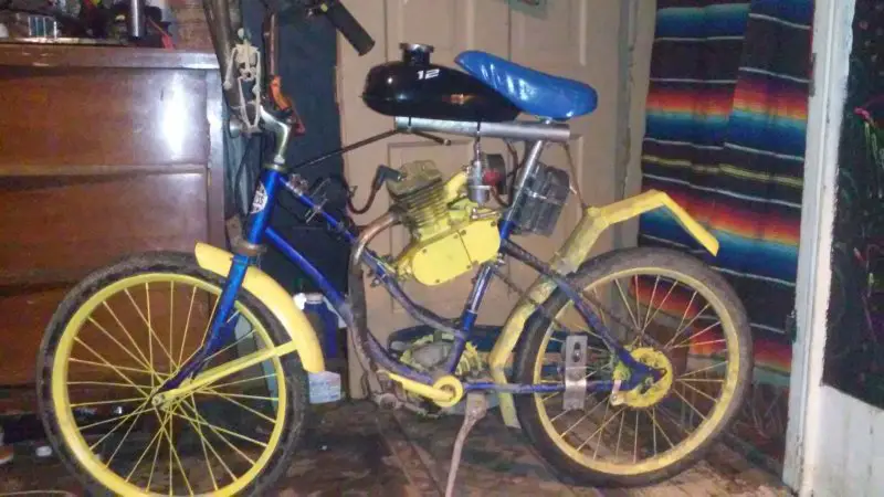

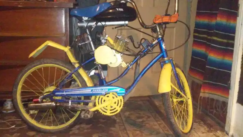

Hi all, so ive been tinkering with my bike a lot and ran into an issue. Whilst riding, ive noticed that my engine dont want to rev all the way out at WOT, with that being said i have a 32t sprocket, it runs fine at an idle and revs full WOT with clutch pulled in as though while riding i have to almost keep a constant pedal (flat ground ) I'm thinking i have too much compression loss but there are no leakage anywhere around the engine, I'm thinking about getting a moon expansion chamber soon to see if that helps, any idea's ? Ive also dropped the needle due to wet plug. 64Peerless~

A new Stock engine will not give you the best performance til after a hundred miles or so.
I would advise no modifications until the engine is well broke in. Anyway-- A lot depends on How much YOU weigh, and your riding environment (Hilly compared to flat ground) ... 32 t sprocket is by no means a torque friendly situation for a new motor. Good only for top end speed on flat ground which is good with a strong motor. I been through this a couple times and My exp. has proven - I weigh 155lbs / very hilly terrain - a 44T sprocket is best, although on my daily driver I run a rebel gear 40T. In a nutshell... That 32T sprocket may be too small. Just my opinion...
Others will chime in.

I agree with whats said albeit i have my engine on a 20 inch frame (; i had the 40t sprocket and was going nowhere fast, i changed my plug to a champion and did away with the stock plug socket to a better one, also on my last tank for break in, i tore the head and jug off and noticed my top ring was broken i have some on the way along with the moon chamber, with the plug change and plug cap change it has a far better spark and seems to be pulling better i weigh 140lbs over all i was able to pull around 25-26 mph according to the speedo app. I do believe i may have some back pressure issues due to the exhaust,

All of this would've been real important information to tell us on your original post!!! (Don't you think)???
