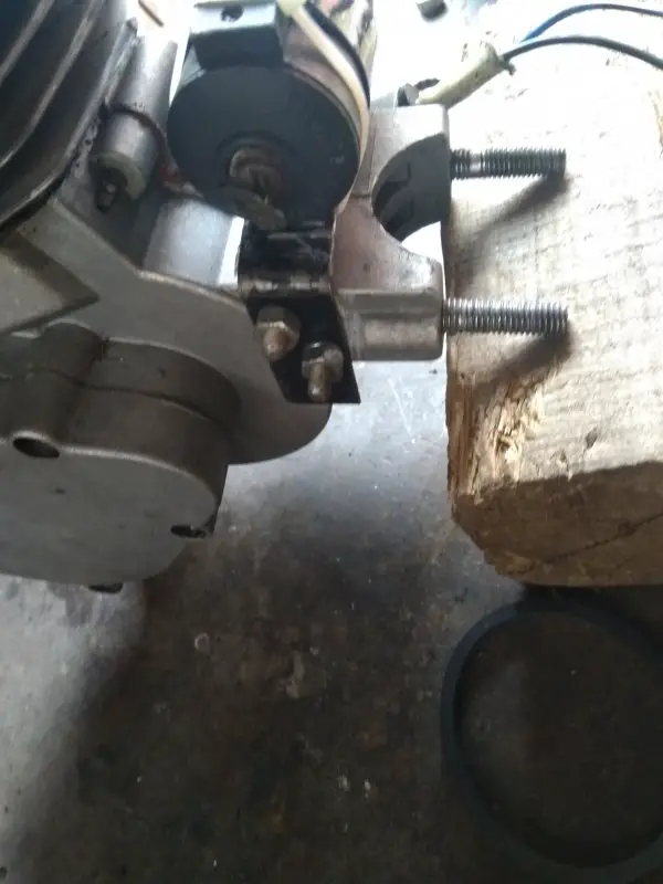

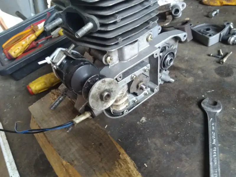

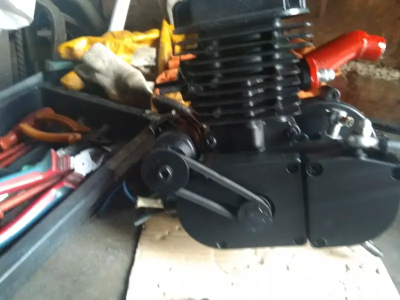

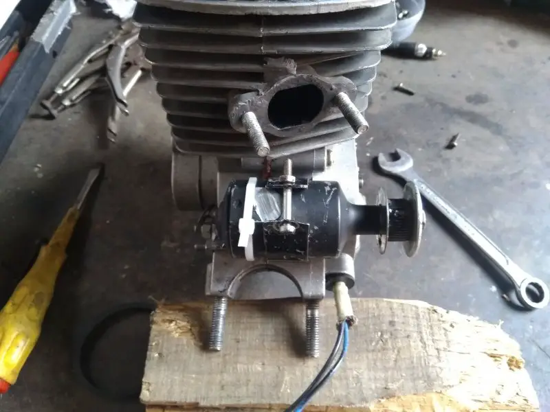

Hi i am posting this thread so i can help more enthusiasts i tried to make an electric bike system because i drive a lot in the evening and with a regular lantern i don't see much and i have to change batteries often so i decided to use the engine to drive a bike dynamo 6 volt 3 watt I welded two washers to fit the belt into the wheel of the dynamo and two more at the crankshaft outlet on the magnet side I think it worked out well I idled it giving about 5 volts and with slightly fed gas it reached 10 volts to 1 amp no p is feeling a lot of power loss when starting cut a hole in the lid and the lid itself in half to get the washer not to interfere with the lid of the dynamo itself I made a stand of sheet metal and hung it on the side of the bolts holding the crankcase in place of bolts I twisted two studs I think it worked out well!
