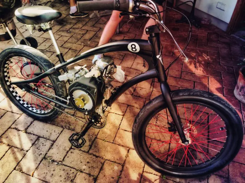

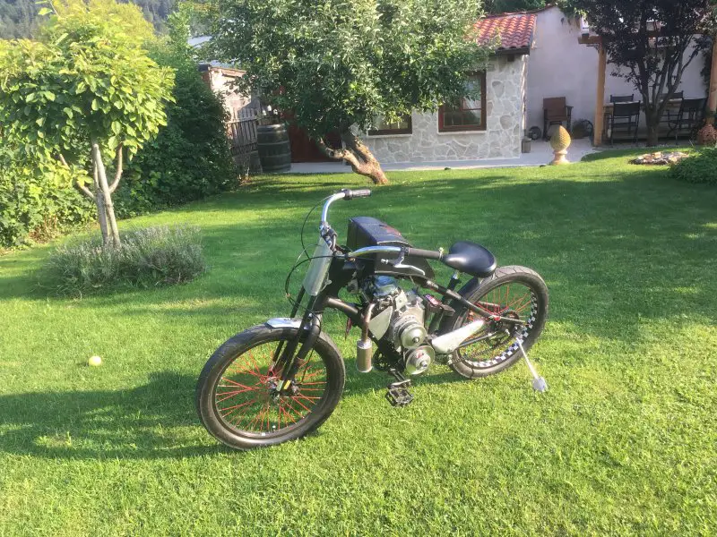

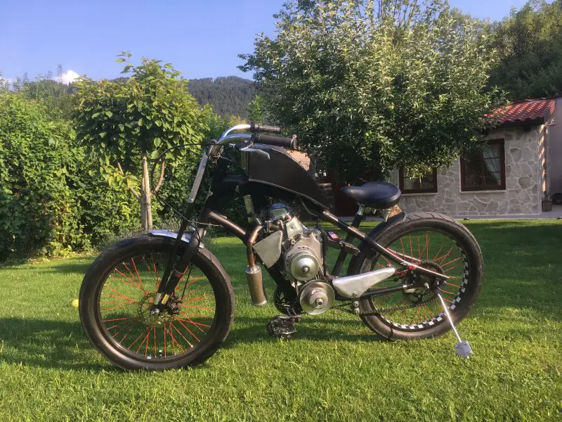

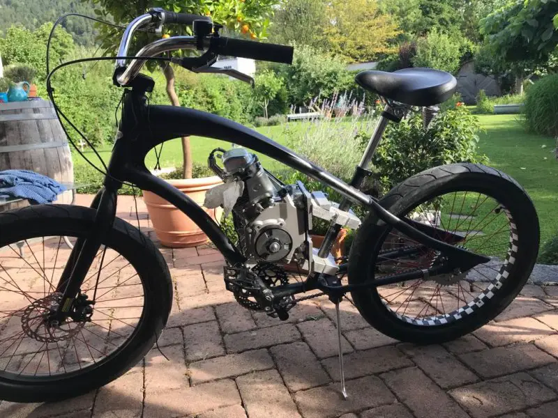

Lenn!legacy New Member Aug 7, 2019 #1 put in a electra straight eight a predator 212 cc or a honda clone Installed a centrofugal clutch and built a custom manifold

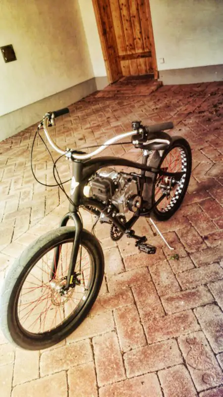

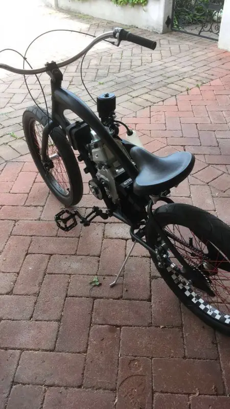

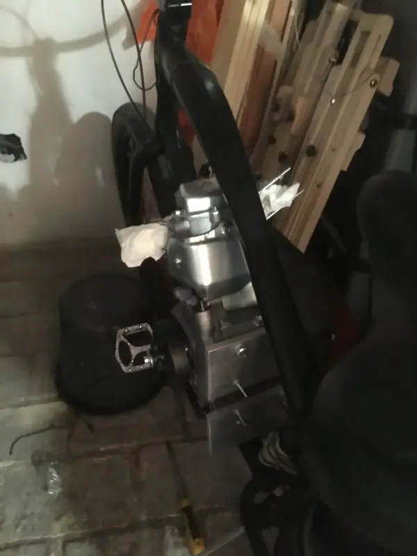

Lenn!legacy New Member Nov 6, 2020 #5 New pictures Attachments IMG_8704.JPG 173.9 KB · Views: 409 IMG_8705.JPG 183.7 KB · Views: 359
Venice Motor Bikes Custom Builder / Dealer/Los Angeles Nov 7, 2020 #6 It looks awesome! but does it actually pedal?
Ralph hop Well-Known Member Nov 7, 2020 #7 Cool bike! No problems with oiling with the engine tilted forward past verticle? Does it have the stock connecting rod with the oil dipper or another rod?
Lenn!legacy New Member Nov 9, 2020 #8 It has the stock connecting rod and no mods on the dipper! Just needs more oil (590ml-710ml or 20oz-24oz)
