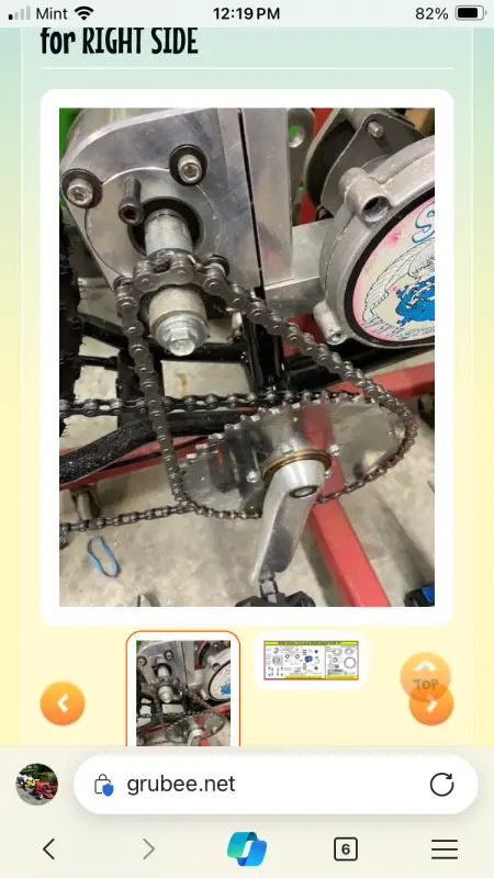

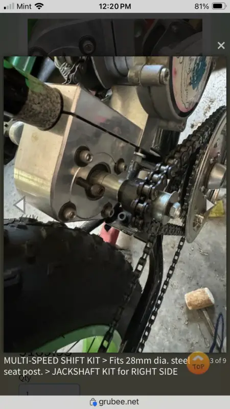

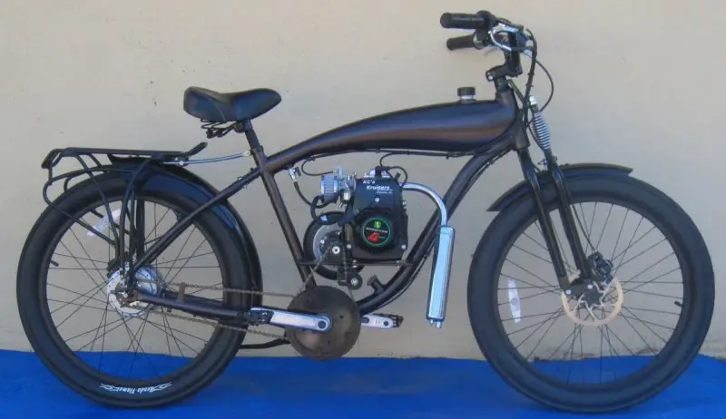

I am getting together components to build motor bike with 80cc Skyhawk with Gru Bee Jack shaft kit.
Other than the 3” back tire spacing from down tube not quite sure on the 28 or 32 kit with respect to down tube diameter?
Like to purchase the Jack shaft & motor now, while available
Anyone do a fat bike build using the Gru Bee Jack shaft?
Any input greatly appreciated

The seller has the wrong term written for the 'downtube'... they mean to say 'seat post tube'!!!
(The downtube is the tube that runs from the fork down to the crank bracket).
To answer your question... go buy a cheap caliper & measure your seat post tube... that will tell you if you need a 28 or 32. ;)
Typically a 28 is a steel frame and a 32 is aluminum. The GruBee Jack Shaft Kit is designed for a Micargi Slugo, requires more forward stance in the frame.
There is a Jack shaft kit that will fit Mongoose Dolomite or the Ecarpat readily available
SickBikeParts gone so
Either I find a Macargi Slugo or a clone, the GruBee is dead in the water.

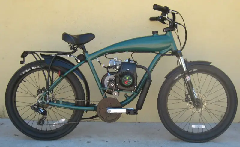

Here's a Mongoose Dolomite I seen earlier today but can't find the post now

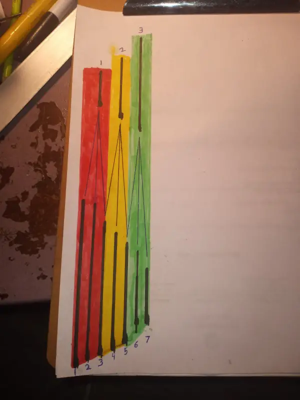

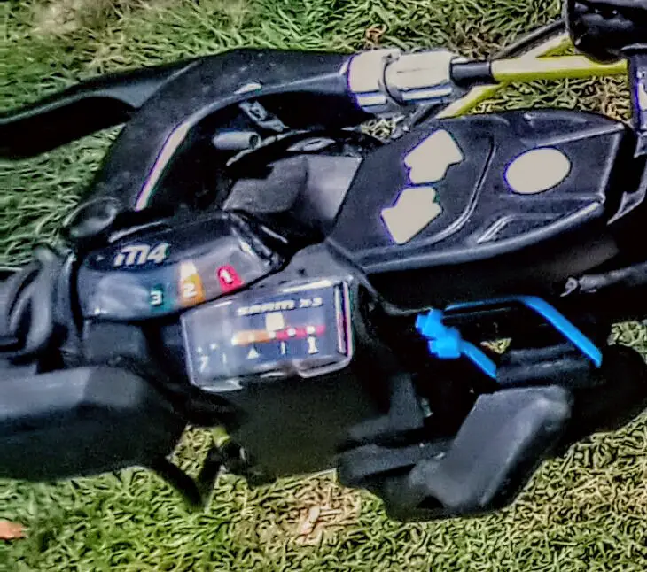

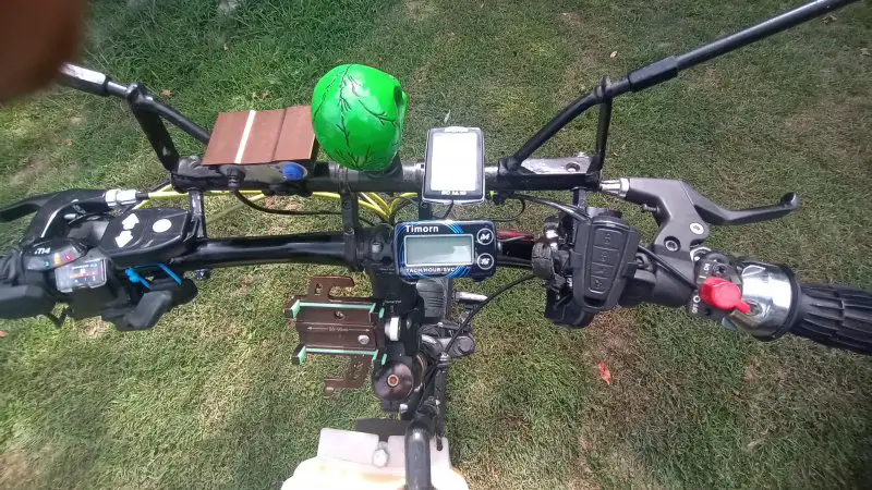

I use a 4-stroke Robin Subaru EH035 engine. I have a triple chainring shift kit. I use 2 Sram trigger shifters mounted on the left handlebar.
I invented a color-coded one-hand shifting system. With this system, the bicycle chain stays in a fairly straight line with no cross-chaining. I only shift a front chainring when in either rear sprockets (3) or (5). The 3 colors are for different riding scenarios. So the majority of the time I'm only shifting 3 gears. My starting gears are 1(1) for starts going up hill and all other starts are 2(3).
My max hp rpm is at 7000 rpm. I use a tachometer to shift by. This way at full throttle I'm always in a gear where I'm at max hp rpm. Thus increasing my average speed in hill country.
