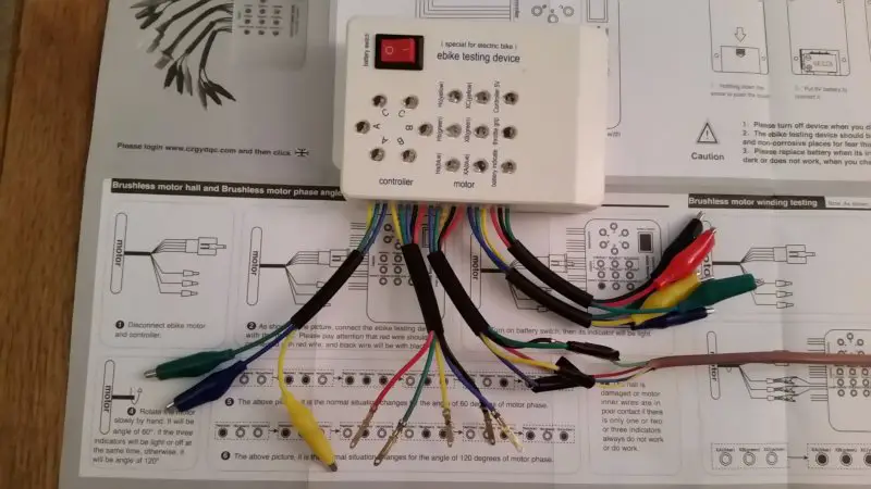

This inexpensive tool is easy to use, and preforms 5 important eBike diagnostic tests that allow you to diagnose most of the common eBike failures. It tests throttles, controllers, hall sensors, motor windings, and brake switches. This tool saves time, and money, because you no longer have to resort to guess work substituting parts on your bike that aren't bad.
The only obstical I found using this tool was I had to make some adapters to be able to attach the tool to male, and female pins on plugs that are too small for alligator clips to connect to.

When you test a throttle with this tool all it tells you is there's signal, or no signal. Signal, and a LED light comes on. Release the throttle, and the light goes out.
