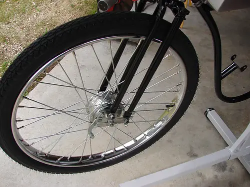

Here is one way to do it. Weld the pin to the left rear shoulder bolt head. All the shoulder bolts should run with the head towards the wheel and the nylock on the outside. Norm showed me this trick.
Racer by Sportsman Flyer, on Flickr

It will only work if you weld the pin to the rear dropout bolt (like in Pat's picture)...
Any other place won't let the dropouts swivel properly during spring action!
