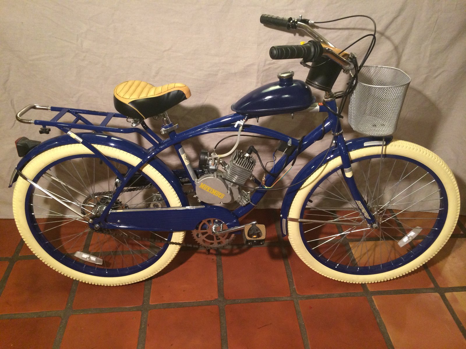

Dont you just love it when a seller on ebay claims to have the best engines available and says after running all the others he has decide to sell only one type because these are the only ones that will hold up, and then you look at his photos he attached to his add and what do you notice that is wrong in these pix....
I know it may seems I'm just being a critical jerk here, but come on if you cant even get the simple things right.......!!!

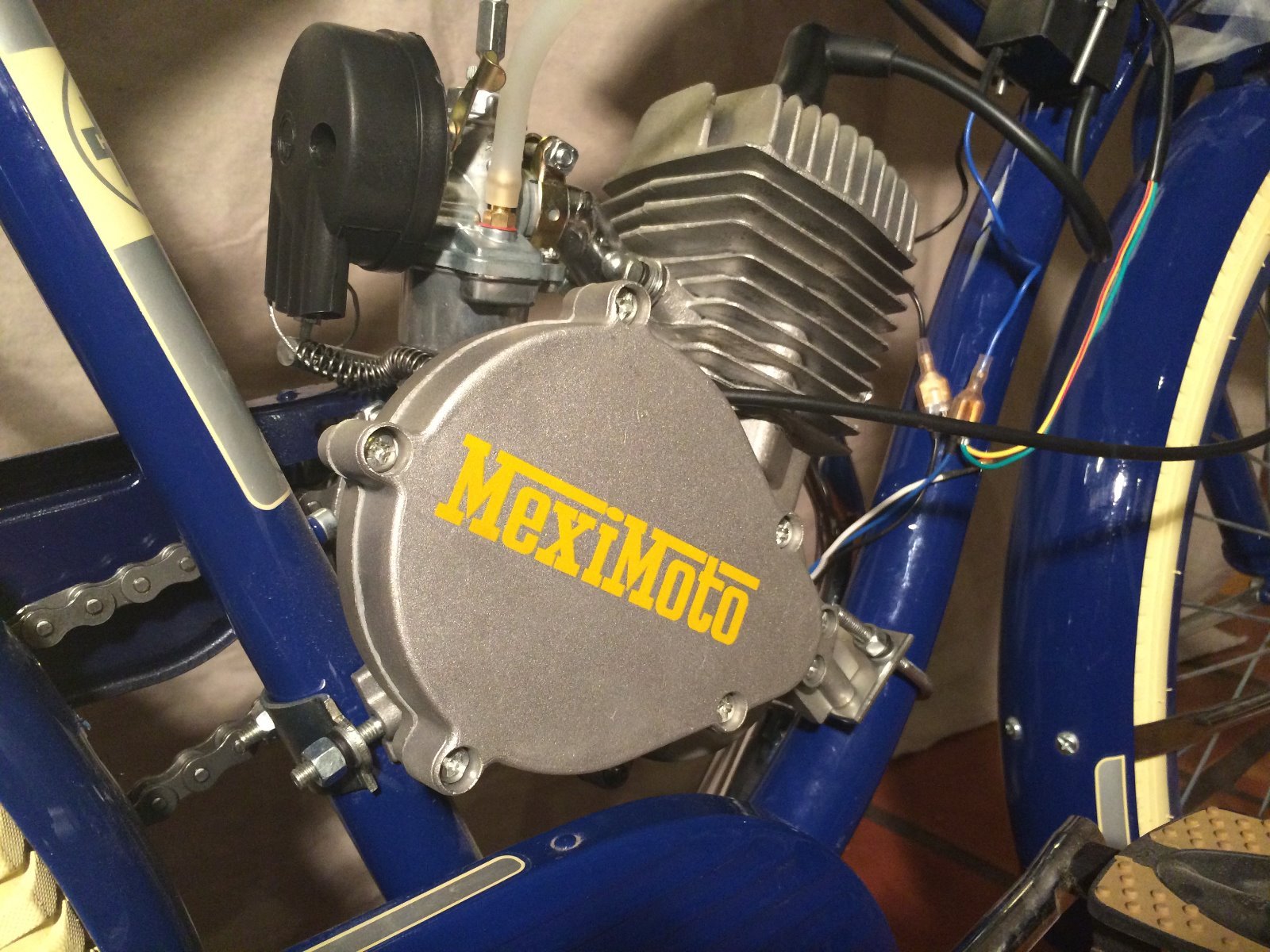

The head is on sideways, yeah it will run but it cant cool as weel as it should since the air cant pass through the fins while the bike is move about.

And yes its a good idea to run a fuel filter since many of these fuel tanks have some crud in them.
Aside from the head on wrong, lol. What kind of moron decides that someone elses product is so good that they claim it? Guy is probably not even Mexican, all kinds of fail here.
...and the clutch cable heat guard spring.
He not only left the lame small spring on, but put the heat guard spring over it!.

It may well be a fine engine but that certainly is someone that would not know the difference hehe ;-}

Very sloppy presentation bike... and I can only imagine how tight that clutch is to pull... but that sideways head really takes first place in the "epic Fail" competition...

Yep, the head turned sideways was the one that got me right off...
Maybe it makes more power because the spark plug is pointing at one of the transfers... and that decal on the clutch cover makes me really believe this is a genuing Meximoto engine.... And no fuel filter so there's no restriction in the fuel flow, it's gotta be better quality than the Chines made ones... laff

Not really the topic but that bike needs front brakes and fender reinforcements.
Chances are he or she reads this forum and also don't wanna come across as unkind and just sayin' And is a pretty build. Just needs some touch ups.

If your going to sell motors, you should at least know what your selling and how they work
